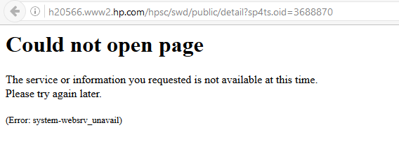

When I click on the answer link the page I receive says
I also tried internet archive and the page wasn't archived...
