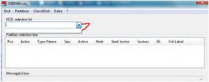

In the meantime, can you tell me what I am doing wrong with the MBRWhiskey run that I am not getting the selection of drives? This is all foreign language to me and I'm doing the best I can to follow and to do the things submix8c is instructing me to do, but it's not going too well, so maybe if someone else would step in and help clarify some of the points for me ...

Didn't you notice a Pull-Down?
"HDD Selection List" (and a "down" arrow).
Click on the arrow then "select" "Disk: 0 Size: 290-somethingG CHS: (etc)".
Watch the magic happen. ;)
Your main HDD is appearently a 300GB so it'll show as less than that.

Quote from my answer: There is nothing in the box which opens that allows me to SELECT anything. I click on the arrow in the empty box under HDD Selection List and there is nothing there from which to make a selection. Am I supposed to type in the name of my Hard Disk? If so, that is not what you instructed. You instructed me to select my HDD and to not select my USB drives which would lead one to assume there should be a list there of all my drives.
I DID click on the down arrow. There is nothing there! No magic, no nothin'!

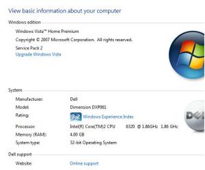

Are you certain that you have Vista 32-bit? :unsure: Check in "Control Panel->System".

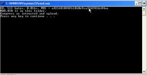

You don't have much faith in me, so I'm attaching a picture to assure you that I have 32-bit.
What was double clicking on the MBR.bat file supposed to do. I did that and nothing happened.

Nonsense! Here's what happens on double-click.
How about you try right-click on "MBR.BAT" and select "Run As Adminisrator"?
Oh, just DUCKY! It gave me "access is denied" until I did the above.

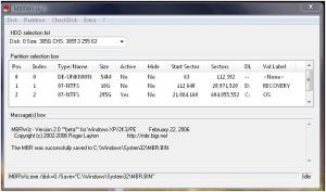

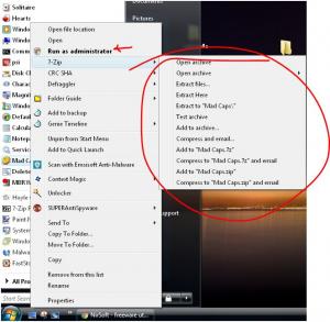

When I double click on MBR.bat I get the command box, just like you did. As soon as you press a letter to continue the box disappears.
I can't right click on the file. As I told you, I lost my "Run as administrator" option on my right-click menu ... UNLESS I can pin the item to the Start Menu. Then I can right click and the "Run as administrator" shows. Under just normal right-click usage, it does not. It's been gone for a long time and I searched and searched for an answer but never found one. I tried to pin MBR.bat to the start menu so I could get the option but I guess that's not allowed with this type of file because the option to PIN it did not appear.
I just went and pinned MBRWhiskey to my Start menu, then right clicked to run as administator and got the list. I do not trust myself to select the correct item so I'm attaching a screenshot and ask you to tell me which one.
post-142907-0-83147400-1455929017_thumb.

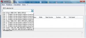

You have your External USB drive plugged in (Disk 5)? If so, why do you still have it attached?
You also have two (?) USB stick plugged in (Disk#9 and Disk#10)?
Your main HDD should be Disk 0. Select that one.
Side note - Never have any USB or SD-Cards plugged in when doing these operations. It only confuses things and gives a potential to really screw your setup up. We're messing with internals here!
Side note#2 - it appears to be possible to install Recovery (NOT BACKUP) software for your Windows 7 to recover your Original Vista. Unsure at this point. We'll check for that later.
BIG EDIT! Run As Administrator is missing? Someone has been screwing with your PC, right? Don't fib!
This should fix it.
http://www.sevenforums.com/tutorials/200558-run-administrator-add-remove-context-menu-windows-7-a.html

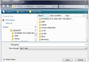

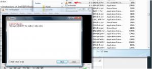

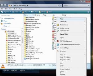

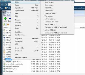

Foiled again! No window opened after I selected "Save MBR to file." I took a picture of the screen and will attach that since that's all I can do. On the bottom of the screen it says "The MBR was successfully saved to C:\Windows\System32\MBR.BIN." I followed that path and there is no file or folder in there labeled MBR.BIN. The only thing in there labeled MBR was an icon for VLC Media Player. When I clicked on it ... see screenshot.
HOLD UP! Keep in mind that I had to run MBRWhiskey from my start menu to utilize "Run as administrator" command. I tried something different and I got a window this time so let me try to complete the rest of your instructions.
OK, apparently that MBR file with the VLC icon is probably right. But then you want me to Right-click on "MBR.BIN", select "7-Zip", then "Add to MBR.7z"Once again, I can't perform the task. I have 7-zip on my right-click menu but it's dead. I used to be able to access its context menu and just select "extract" but 7-zip itself is non-responsive. So I don't know how I can add MBR.BIN to MBR.7z.
I uninstalled 7-zip using Revo Uninstaller Advanced mode. I checked the right-click menu and it was no longer there. Then I downloaded the program from the company site and installed it. After installation 7-zip was on the RC menu, but just as dead as it was before.
post-142907-0-39349800-1455940046_thumb.
post-142907-0-91905600-1455940055_thumb.
post-142907-0-94054700-1455940784_thumb.

I'm giving this up for tonight, but please see my last screenshot here. You can see that if an item is in my Start Menu, I not only have the "Run as administrator" command, but 7-zip also works the way it's supposed to.
post-142907-0-71660300-1455945829_thumb.

============ Post#85 ============
IGNORE THIS SECTION! PRECEED TO NEXT RED HILITE!
How on God's Green Earth did MBRWiskey manage to save in "Windows\System32" folder? The default to save it is in the same folder as the Program is! You're not providing information as to HOW or WHERE you're doing things in detail. This is causing a miscommunication and requires me to "figure out" exactly what's going on! NOTHING should be running from that folder. NOTHING THAT YOU'RE RUNNING SHOULD BE THERE!
EDIT! Figured the above out (see bottom of this post).
You put "somehow" that stuff in "Windows\System32" via
-Search for CMD.EXE
-Right-Click and "Run As Administrator"
-It takes you directly to that folder.
No freakin' wonder!
That also explains the screen pic confusion of "Cindy" vs "Administrator".

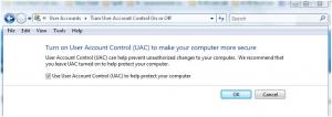

ALSO! Forget "Enabling Administrator" (bottom of post)!!! It seems that having UAC TURNED OFF totally disables "Run As Administrator". TURN IT BACK ON, REBOOT, AND SUFFER THE POP-UP MESSAGES FOR A WHILE! LET'S GET THIS SHOW ON THE ROAD!!!!
The screen pic with "VLC" in it is overlaying the left hand side. It APPEARS that you're signed on as Administrator! No WONDER it isn't showing "Run As Administrator" because YOU ARE THE ADMINISTRATOR! Bad mistake running under Admin! Real bad! IGNORE! SEE ABOVE!!!

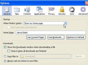

As for using 7-Zip to create a Compressed File, run "7-Zip File Manager", go to "Tools" then "Option" then the "7-Zip" Tab, then check-mark (select) EVERYTHING there EXCEPT "Icons in context menu" (unless you really want that). Exit 7-Zip. IGNORE! ALREADY SET!!!
DO THE FOLLOWING! GET DOWNLOADS OFF OF DESKTOP!!!
Next, why on God's Green Earth are you saving the downloads and extracting to the Desktop? Bad idea on Vista! Always save stuff in something more appropriate, like "Downloads". You're using FireFox so you have the "Default Download Location" pointing to "Desktop". CHANGE THAT because it's (again) A BAD IDEA! Here's mine (see screen pic) and I'm betting you have your Default set to your Desktop.
Go to the top and click "Tools" then "Options" then the "General" Tab (like mine) and fix that!
Now MOVE all of that stuff you downloaded FROM the Desktop TO Downloads.

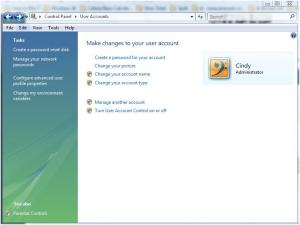

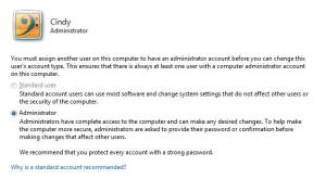

UserID "Cindy" is a "Stadard User" and has absolutely no powers to RunAsAdministrator. I just created one and Right-Click "RunAs" does absolutely nothing! I'm suspecting Dell has done this during Setup/Recovery. Dumb Dell! I'll see what I can do about that. Probably using Safe Mode (F8) and logging on as Administrator then changing "Cindy" to an Administrator.
http://www.howtohaven.com/system/standard-user-account.shtml
Be right back...
1-Under "Cindy" account, do this - https://support.microsoft.com/en-us/kb/555910
2-Log "Cindy" off.
3-LogonOn to Administrator.

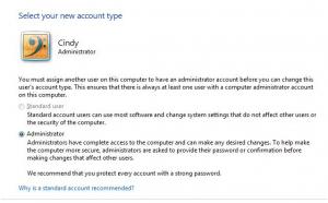

4-Go to "Control Panel". Your final destination is "User Accounts"
5-Select "Add/Remove" to get a screen of All Existing Accounts
6-Select "Cindy" and change the Account Type to Administrator.
7-LogOff and LogOn to "Cindy" - NOW everything will work!
BE FOREWARNED that you may want to reverse this later on. Simply do the exact opposite -
1-LogOn Admin
2-Change "Cindy" to "Std"
3-LogOff/LogOn "Cindy"
4-Do #1 except replace "yes" with "no"
:crazy: (note- NOT "Switch User" but LogOff/On!!!)
This has not been a fun exercise. I've had to experiment to figure out what your setup is.
I only have one account and it is named Cindy-Administrator (Scrshot 3), but apparently I do not have full administrator rights because when it calls for running something as administrator I have to have that "run as administrator" command and the only place I can access it is from the Start Menu.

2a - Go to that MBR file and CUT it and MOVE it to that SAME DOWNLOADS FOLDER!
Done as stated above, but still can't right click on it and do anything with 7-Zip because no access through the right-click context menu.
IDEA: What if I open 7-Zip, find the MBR.BIN file in Documents (now) and right click it from there (inside 7-Zip)? Well, that worked (Scrshot 6) as far as I could tell so I will be attaching that.
NO! I said RIGHT-click to get the Pop-Up Context Menus!!!
I know the difference between click and right click. I was right clicking!!!
http://thestarman.pc...r/PartTypes.htm
What on earth did you include this for? I do not have the knowledge or experitise to decipher this and it meant nothing at all to me.
WHERE THE HECK ARE YOU AT THERE - WHAT FOLDER? YOU HAVE WHAT YOU NEED IN YOUR CONTEXT! RIGHT CLICK ON "MBR.BIN" SELECT "ADD TO MBR.7Z"! You OBVIOUSLY know how to use Windows Explorer (not Internet Explorer), RIGHT? (holy schmoley!)
How many times do I have to say that my right-click context menu is not right -- it doesn't work right for all things? The only place I can get the "Run as administrator" option is if I right click on something on the Start Menu. I have now discovered 2 places where I can get the 7-Zip options menu and they are on the Start Menu, or from inside 7-Zip itself. I tried right clicking on the MBR.BIN file from within Windows Explorer and it did not give me the 7-Zip options menu, I tried from my desktop, from Documents, from C/Windows/System 32 and it did NOT work. The item "7-Zip" is there, but when I click on it the extended options menu does not open. Nothing happens.
PLEASE pay atention! Click is NOT the same as Right-Click. Right-Click an EXE/CMD File Extension (that's what the Reg entry fixes) to "Run As Administrator" - CLICK to "Run As Cindy". RIGHT-Click to "Extract" -or- "Add to" a Compressed Package using 7-zip!!! 7-Zip is NO DIFFERENT than Rith-Click and "Send To->Compressed Folder" (creating a ZIP file as opposed to a 7Z File). WinRar creates RAR files. ALL OF THESE ARE COMPRESSED AND MUST BE EXTRACTED TO EXECUTE ANYTHING THAT ALLOWS "RUN AS"!!!
(... tutorials galore... wow!)
RIGHT-CLICK MENU DOES NOT WORK RIGHT as explained above and over and over and over.

Hrmph!
This is not your account! It's the built-in Administrator account.
Lesson time (just like the "INFO ONLY" and links given).
In Vista there are two "user groups"
1-Standard Users
2-Administrators
"Cindy" is in group Administrators. So is the Built-In Account.
Don't do Step#5 (adding a password). It's just "recommended".
Log Off. You should see two Users on the "Welcome" screen -
"Administrator" and "Cindy".
Click on Administrator.
Go to "User Accounts".
Click "Turn User Account Control On or Off"
Make sure it's set to "On".
-If Not On, Set it to that and Reboot.
-If On, just exit and Log Off.
Note1 - UAC must be set to allow for Right-Click "Run As Administrator".
Note2 - So, basically you allow just anyone to start your computer and get into your "Cindy" Administrator account? Tsk-tsk...
Now "Cindy" account should be able to "Run As Administrator" and MBRWhiskey should run normally.
Also nothing need be "pinned".
If not, log off and try the same thing in the "Administrator" account.
Report back.
Your MBR is a Standard (not "special") one.
BE SURE you have all your Data backed up.
Lesson#2 -
The links I gave was so you'd understand about your Disk's Partition Layout.
1-Partition#1 Type=DE - Dell "UTILITY" Partition (hidden)
2-Partition#2 Type=07 - Dell "RECOVERY" Partition (visible NTFS format)
3-Partition#3 Type=07 - Dell Vista "OS" Partition (visible NTFS format)
The "goodells" link was (again) so you'd understand how Vista Recovery works.
I'm suspecting that the "Genie Timeline" software you're using won't be worth a hang for what you need to do.

To RESTORE TO FACTORY (if need be AFTER you've installed Windows 7) you will need -
1-That MBR Backup
2-FIRST Partition (see above)
3-SECOND Partition (see above)
The THIRD parition will be COMPLETELY REPLACED with Windows7 Clean Install.
Email: P.S. I tested the Right-Click in my Vista Test. It WORKS if you TURN ON UAC (I gave a link to that as well?) You're NOT telling me some key factor here. POST THAT SCREEN SHOT OF USER ACCOUNTS because I'm not believing everything you say anymore.  :dubbio: IOW, WHY is YOURS "not working" and MINE IS????
My UAC is turned on. It's never been off. I would guess that mine isn't working because something in my system has been corrupted or lost and there are some things that aren't working because of it. You accuse me of not telling you everything. I send you screenshots of everything and I just don't know what else to do. You want pictures of my user account so I'm attaching 3.

I have downloaded ToDo. But I don't understand about the MBR file. Above you called it "That MBR backup" and here you refer to the "MBR file you backed up." Please clarify exactly what MBR file refers to.
Now I'll look more closely at your post #89. I guess I'll try to take care of this administrator account thing and if I can get back into my computer I'll be back.
