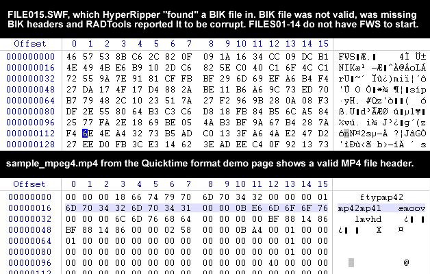

Tripredacus Posted December 17, 2015 Posted December 17, 2015 The files are not actually MP4 files. They have an extension of SWF but they aren't those either. Normal MP4 files have a file header that says ftyp followed by a designator as seen in this list:http://www.ftyps.com/ Two MP4 files I have on my computer for comparison have ftypisom and ftypmp42. The SWF files on the OneDrive link do not have file headers at all. This is why I believe that the files the OP uploaded are not going to be very helpful in recovery and that the original SD Card should be looked at again instead.
jaclaz Posted December 17, 2015 Posted December 17, 2015 (edited) This is why I believe that the files the OP uploaded are not going to be very helpful in recovery and that the original SD Card should be looked at again instead.Yes that is exactly the point of my previous post. The SWF files on the OneDrive link do not have file headers at all.Naah they have it (I quickly checked file #15 ONLY): 4657538B Now the 465753 is FWS (i.e. the correct header start for a SWF or ShockWaveFlash file) problem is that the 8B is version, i.e. version 139! jaclaz Edited December 17, 2015 by jaclaz
Tripredacus Posted December 17, 2015 Posted December 17, 2015 Interesting... all my SWF files have CWS in their headers...
jaclaz Posted December 18, 2015 Posted December 18, 2015 (edited) Interesting... all my SWF files have CWS in their headers...FWS i.e. SWF is the beginning of the header for "normal" Flash files.CWS i.e. SWC is the beginning of the header for "compressed" Flash files. Reference (JFYI):http://www.file-recovery.com/swf-signature-format.htm jaclaz Edited December 18, 2015 by jaclaz
