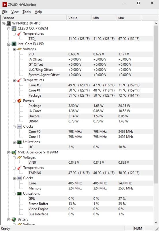

@noel thanks for posting the data. I notice the minimum cpu voltage in windows 10 at 1.083V where as it is 0.6 in windows 7. Something is off in that regard. possibly why the temps are being reported higher in win10.

Audit Mode:
"Normal" Mode:
The average temp is a little higher, but while in "Normal" mode, it will spike occasionally. It does not do this in Audit Mode. I will say that this "Normal" test was done without having anything open and having no internet connection.
I wish you had chosen to expand the Clocks field in the first screen grab.
-Noel
id guess it would be around 800 mhz since the voltage is similar.
I didn't change anything each time I open the program. I don't know why it did that.
Probably a minor bug.  I noticed that when I was doing my captures I had to expand some of the subheadings.
