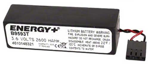

From the pictures and description, this board uses an external battery pack connected to jumper J24...much easier to work around than a dead Dallas chip.
  • Author
Actually the sellers message reads "Battery module is not installed - CMOS invalid checksum."  Did you see an external battery pack?  I studied it but didn't see one.  I did study up on replacement batteries last night and found this one that plugs into the motherboard so it looks like an easy fix.  So it plugs into J24 on the mb?
http://batteryguy.com/plc-battery-3.6v-2600mah-b9593t.html?gclid=CjwKEAiAnqWkBRCGm5uyu5r13jsSJACBZ4WyJ4Ped2FiD0_j9B4PPXlLHoCkyR1mG1jivd3x9vJyuBoCjVHw_wcB
After looking at a bunch of motherboards from this era I noticed all of them had the blue barrel shaped Nicad batteries.  It looks like someone desoldered it from this board.
Edited by Hoko
That's the type of battery I'd expect this would have used, yes. You could rig up a homebrew replacement with AA cells, a holder, and some wire.
