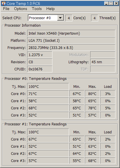

Dave-H Posted September 2, 2014 Author Posted September 2, 2014 Hi again, I'm sure I posted a reply this morning, and just came to edit it and it seems to have disappeared, no idea why! Anyway, as I thought I had already said, I installed SpeedFan which seems to work very well, but gives a huge amount of rather complicated information from loads of apparent sensors, some of which appear to be duplicated. It is showing high temperatures on "Diode 1" which are always about 10 degrees above and sometimes 20 degrees above the other readings. SpeedFan doesn't seem to work on Windows 98 either, although the documentation says it should do. It installs OK and scans for the system information OK, but then puts up an exception error message instead of showing the readings. I also found a utility called Core Temp, which seems to give just the information I want, and that looks relatively happy! The system's quietened down again now, as long as Windows XP is running, however when I reboot the system fans are taking off again, and the BIOS hardware monitor is showing PECI Agent 1 as high but PECI Agent 2 as low, which is what I can't understand. I still have a horrible feeling that there is a hardware fault, as why would one processor be apparently running so much hotter than the other? I know it's not the processor itself as swapping them doesn't move the problem, and nor does swapping the heatsinks, whose fans both seem to be working fine and there's surely nothing else that can go wrong with them!

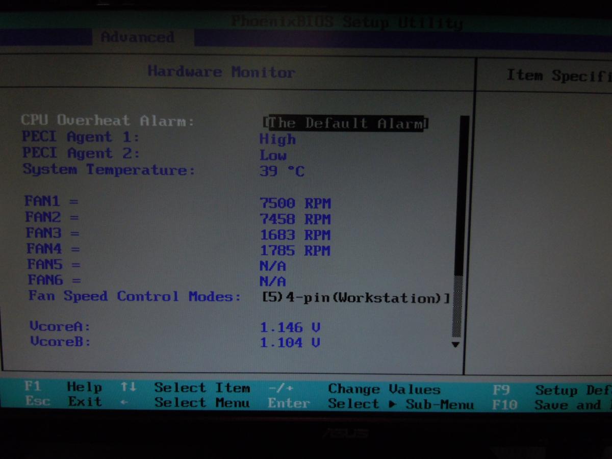

Dave-H Posted September 3, 2014 Author Posted September 3, 2014 What is actually happening is that the system is fine when first switched on, and while using Windows XP normally. If anything stresses the processors at all, the fans ramp up in speed, as would be expected. Most of the time they are just idling however. If I reboot after the system has warmed up however, the fans immediately start roaring away at full speed when Windows shuts down, and if I go into the BIOS setup, I can see that one processor is reporting high, and the other one reporting low, as in the picture below. This never changes and I've never managed yet to leave it long enough to cool down to change that, in fact I've left it for so long without change that I think it's a permanent condition until I switch of and let it cool completely. Supermicro's "SuperoDoctor III" monitoring software apparently takes over from the BIOS when it loads under Windows, and its settings are used instead of the BIOS settings.
