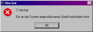

I tried to use either function FirefoxPrintB or FirefoxPrintA. Both work fine while the URL got by gBrowser.currentURI.spec is not long.
If I use FirefoxPrintB I additionally use a file called fire.bat with following content:
D:\Programme\Mozill~2\firefox.exe -print "%1" -printfile C:\zzw.png
The mentioned error message looks (in german) like this: post-254155-0-78636900-1396432390_thumb.
If I change the content of fire.bat for test to
D:\Programme\Mozill~2\firefox.exe -print "http://www.google.de/search?hl=de&as_q=dos+command.com+long+parameters&as_epq=&as_oq=&as_eq=&as_nlo=&as_nhi=&lr=&cr=&as_qdr=all&as_sitesearch=&as_occt=&safe=images&as_filetype=&as_rights=nicht+nach+Lizenz+gefiltert" -printfile C:\zzw.png
so it works (with the long URL you can see). I can see in the "DOS-Box" after executing fire.bar that the whole URL is inserted.
So I think it must be a problem while copying(?) the URL to "%1" in the first version of fire.bat.

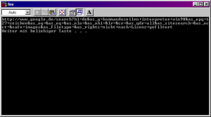

If I use following fire.bat:
@ECHO OFFECHO http://www.google.de/search?hl=de&as_q=kommandozeilen+interpreter+win98&as_epq=127+zeichen&as_oq=&as_eq=&as_nlo=&as_nhi=&lr=&cr=&as_qdr=all&as_sitesearch=&as_occt=&safe=images&as_filetype=&as_rights=nicht+nach+Lizenz+gefiltertPAUSE
then I get the following output:
post-254155-0-99950700-1396632897_thumb.
You can see that the (long!) example URL contents many special characters, which are shown correctly in the command line output.
So in my opinion it is obviously the problem how to get the URL variable, "created" as String with the command gBrowser.currentURI.spec, to the command line.

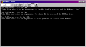

Try running this batch:
@ECHO OFFECHO The following line is OK:ECHO "This line contains an ampersand & inside double quotes and is ECHOed fine"ECHO.ECHO The following line is OK:ECHO This line contains an ampersand ^& since it is escaped is ECHOed fineECHO.ECHO The following one it is NOT:ECHO This line contains an ampersand & will produce an error when ECHOed
I saved it as echo.bat and started it by double-clicking on it.
Following output:post-254155-0-90667200-1396856858_thumb.
For some (for me unknown) reason the ampersand seems (here) not to produce an issue, contrary to your output.
Could anybody other test one of the posted *.bat-files?
