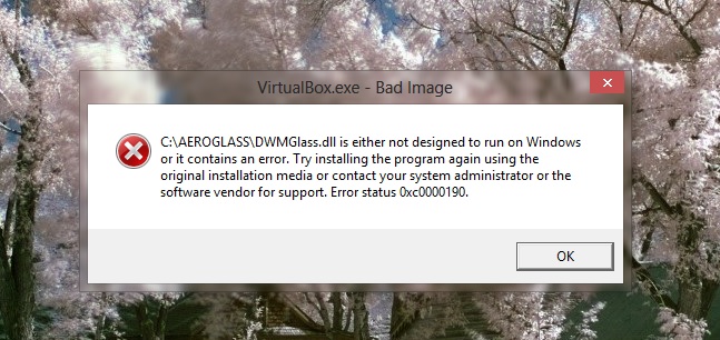

ralcool Posted August 14, 2014 Posted August 14, 2014 (edited) Right, Disable the value that prevents glass disable on battery thinking it will help it be enabled on battery boot..... No that didn't help either. Also got a lovely screen today trying to run VirtualBox for the first time ....After I remembered I was running v1.3, had to open explorer, locate the directory, rename the file- the open task manager to close the dwm process to 'reboot' without glass. There has to be a quicker way to disable glass without the hassle. I spent at least a minute looking for aerohost to kill until I remembered I'm using Win8. More exciting feedback on software usability. Cheers! Edited August 14, 2014 by ralcool
