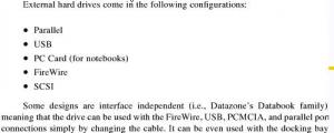

bphlpt Posted January 25, 2013 Posted January 25, 2013 From submix8c's pic above:Some designs are interface independent (ie Datazone's Databook family) meaning that the drive can be used with the FireWire, USB, PCMCIA, and parallel port connections simply by changing the cable. It can even be used with the docking bay.That is truly the way that all external devices should have been designed. For universal application. I know it's more expensive that way, but if only they were all designed to be that flexible.Cheers and Regards
