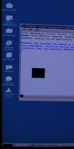

Then I went from 512 meg SDRAM to 2 GB DDR. Tthe onboard video and 98SE really had a hard time to cope with that much memory. I had to decrease MaxPhysPage to about 4000 (!!!) just to be even able to boot, yet the display was still royally messed up. (see attached img) That big black square in the PMTShoot window is the mouse cursor, BTW.

post-86092-0-91919600-1335684626_thumb.j
