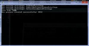

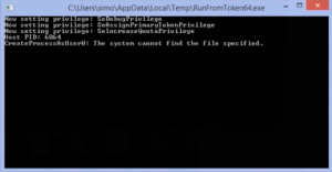

it give me this message:
post-410805-0-48164100-1447426780_thumb.
post-410805-0-78397400-1447426787_thumb.
post-410805-0-03043500-1447426790_thumb.

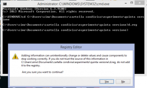

but if I open runasti64 double clicking on the icon, and then from the command prompt that opens write d.reg prompt adds the key correctly.
post-410805-0-18561000-1447426884_thumb.
post-410805-0-91747700-1447426884_thumb.
i dont understand what im doing wrong...

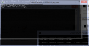

It is possible that RunasTI does not pass all parameters correctly (or only accepts a single parameter, i.e. the name of the executable), the error you are experiencing is most probably in the third screenshot (syntax of reg.exe) which is the same you get if running reg.exe with no parameters.

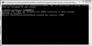

Hi, i try this way but it dont work, now it give me this message error:
post-410805-0-05199200-1447664145_thumb.
thanks for your help,
Simone
Simone
