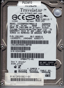

Can you open the enclosure and post here a link to a good quality pic of the HDD's full label, please? And, BTW, how is that enclosure powered? Just through the USB connection? Has it a pair of male USB plugs, of which you're using only one, perchance?

Do you have a scanner? Put the HDD label down in the scanner (with the cover open) and scan it in 600 dpi (just remember not to look towards the scanner while doing it, because the light may har your eyes). Such a scan will be good enough as a pic.
Good idea...see attached, though my max file size is 500K.

Moved the attachement to my next post to save your attachment quota space
It's a quite good pic. I've downloaded it and reattached it to this post, for everybody to have access to it, so that you can delete your attachment from your previous post (to prevent filling your attachment quota too fast). Later I'll get back to the subject, but now I'll have to go. Happy New Year!
Later: here're the specs... this may be a small step forward, but a step forward it is. :)
