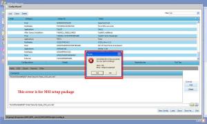

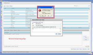

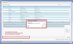

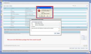

When I add some new programs from CONFIG, and then I try to find a silent switch using the magnifier icon at the right side of the window, I got different errors.
The errors are depending on the kind of setup packages which I mentioned on attached images.
I tested four different packages which I added in previous versions of WPI without any error messages.
USS-Error-01 is for RAR SIlent packages which I made for installing firefox.
USS-Error-02 is for MSI setup package which I used before for installing ESET Smart Security.
USS-Error-03 is for Inno setup packages.
USS-Error-04 error occurs when I have added two commands instead of one command at a time. I hope to see an error which tells me my mistake but it says:
Could not open TEMP directory.
I use Windows XP SP3 X86 and IE 7.0.5730.11
Anyone else has these errors when adding new programs?
