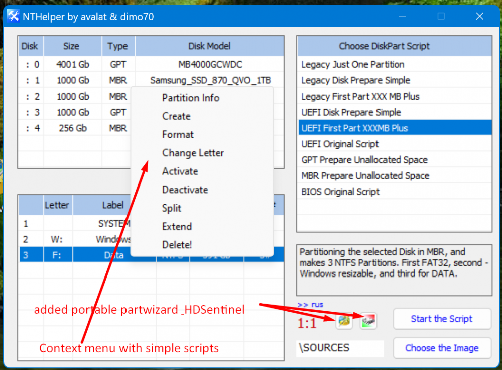

for the time being, I am testing its diagnostics, which seems accurate - right clicking on the drive and getting the data concerning it in a command box. the problem to which I alluded was not due to any fault whatsoever of nthelper.exe, but to the reduction (miniwinning) of any vhd which does not take into account the dlls that any executable requires in order to run properly. what one normally does in such cases is get the specific executable running on an unminiwinned vhd and run process explorer to check which dlls it needs in order to run properly and get a txt listing all of them. then each string on the list (c:\windows\syswow64\blablabla.dll in the case of nthelper.exe) will be turned into something like
copy c:\windows\syswow64\blablabla.dll d:\nthelperdlls
and so on till the end of the list, which will be saved as *cmd or *.bat
Once the dlls have been gathered, one runs the miniwinned vhd and copies all dlls in nthelperdlls to syswow64 and ur software that did not work before will work ok now.
