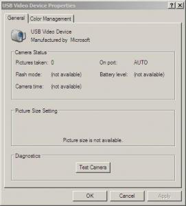

morland Posted April 29, 2010 Posted April 29, 2010 I am posting this after reaching the point of frustration and having spent 2 days trying to find a solution.I have a Sony VAIO VGN-FZ140E Laptop and after doing a fresh XP Pro SP3 install can't get the camera to work. The chipset is Intel® GM965 Express Chipset. I have tried1) Installing SODOTH-12946300-US.EXE (Version : 1.1.07.04020, Last Modified :05/14/2007) - Problem remained2) Downloading and installing the Camera Driver from ftp://ftp.vaio-link.com/pub/OS/XPDOWNGRADE/FZ19/DRIVERS/ but the problem remainsWhen I click on the USB Video Device in Windows Explorer I get the messageVideo Preview FailureCreation of the video preview failed.Please check the device connection and make sure that the device is not being used by another application or user.In Windows Explorer, when I right click on the USB Video Device and from the resulting dialog box, I click on Diagnostics, I get the following message. A related screenshot (if it's of any help is also attached)Your imaging device successfully completed the diagnostic test.Can someone help please.

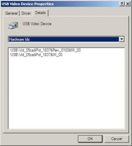

morland Posted April 29, 2010 Author Posted April 29, 2010 Thanks puntoMX and ricktendo64 for your replies. I too would NEVER EVER buy a SONY again. Never. Period.Regarding the Device Hardware ID: I don't know what you are asking for but am making some assumptions and based on that: I went into Device Manager Selected Imaging Devices | Use Video Device Did a Right Click Selected Properties Clicked the Details Tab From the many options in the list, I selected the 2nd one labeled 'Hardware Ids'. Don't know how to copy the text so am pasting a screen shoot (attached) Is this what you asked for?

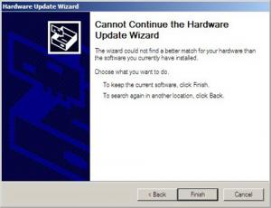

morland Posted May 3, 2010 Author Posted May 3, 2010 (edited) Hi ricktendo64. Just an update. The Vista drivers from http://www.downloadwindowsdrivers.info/usb/vid_05ca/pid_1837/mi_00/ did not work eitherJust an update... Tried the suggested drivers and no luck. When I tried to install the suggested driver, the error shown in the attached image pops up and then when I try to use the camera in Windows Explorer the following message is displayed:Creation of the video preview failed.Please check the device connection and make sure that the device is not being used by another application or user. Edited May 3, 2010 by morland
