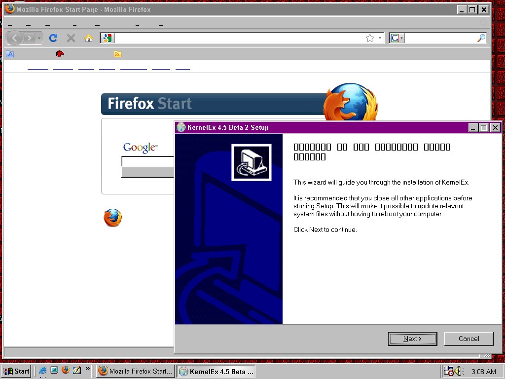

I'm having an issue with KernelEx and some fonts (I didn't want to add to the KernelEx thread because I'm sure I'm just missing something). I'm using 4.5 Beta 2 and Firefox 3.5. Fonts on menus, dialogs, and webpages are completely missing in Firefox, and on some installers there are blocks instead of characters. I suspect it has something to do with unicode support. I've installed all the available updates for 98, and I've tried adding and replacing some of the fonts. I've searched the forums but can't seem to find a solution. Any ideas? A screenshot is attached.

I have also seen this error. I did not post about it because I do not have any screenshots from it, I was only testing KEX in a VM for the first time. I was running a clean install of 98SE with only Plus! 98, DX9 (Dec2006), IE6SP1, WMP7.1, and specific updates required for KEX installed.
I was using Firefox 3.0.18, and no text would be visible at all in the menus, or on visited websites. What was more bizarre, is if I watched very closely, when I first opened Firefox, the text would be there. Then it would shrink down into the "underlines" as if it were being squashed :w00t::lol:
Rebooting the VM would sometimes partially fix the text, but "null characters" would still be visible in some places, especially in the menus, there was always one at the end of each item in a menu.
No text in Firefox is VPC video driver specific bug afaik.
I was running VMware Workstation when I saw the error. (May use the same driver(s) as VPC, I'm fairly new to VM's so I don't know, :unsure: , thought I should mention it though.)

I should have specified, I'm running in a VM (VPC 2007 to be exact). It's very possible that it's a driver issue, but I don't think anything can be done with the video driver in VPC (?). If I had something compatible with 9X I'd try it in a real machine. Also, if it makes a difference, Firefox 2.x builds don't have this problem.

I've tried the VM additions as well as the unicode and other fixes suggested...same problem. I'm willing to chalk it up to crummy video driver support in VPC. I haven't read anywhere of this same problem on a real machine. I'm open to any other ideas...
Seems like some other unofficial extension which you've installed is conflicting with KernelEX. Please state what extensions you've installed. Does that happen when you install Firefox 2.0?
BTW what is your Windows 98's locale?
I had my Chinese IME broken whenever I install KernelEX(All versions after 0.36a?), and had to disable KernelEx extensions for firefox.exe for it to work though.

From what I remembered: It MUST be v1.1.3790.0. No other version would work, and may cause crashes.
about unicows.dll
maybe there are many more unicows.dll files on his virtual harddisk.
The VPC2007SP1 VMAAdditions and the latest Java Runtime comes with outdated versions of unicows.dll.
I deleted the VMAAdditions unicows.dll and I updated the Java-Unicow.dll with/in? the MS-Dos-Mode of Win98SE.
Changing all fonts in the Display-Appearences? to Tahoma(Western) and the Null-Characters in Firefox 3.5.8 are gone.
