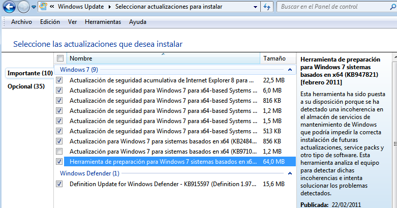

Integrating Sp1 Not Is Properly
Carrying out the integration via slipstreamer RT7Lite with, and checked with the Microsoft Update KB947821 I find the patch, which takes about 10 minutes to install!!
By comparison with the ISO original W7+SP1, the patch KB947821 is not detected by Microsoft Update.
Greetings

true ... if we use the. iso windows technet or msdn 7 + sp1, then integrate these updates, on first boot not appear in windows update,but if we use the lite RT7 to integrate sp1 and updates if they appear on the first boot
However, I have my doubts about the slipstreamer RT7Lite, ISO created is not like that of msdn W7 + sp1.
Maybe I'm wrong, I think the integration of SP1 can not disable or uninstall all the features.
is so since the official version of microsoft
what is clear is that this version is more stable in rt7lite that if we use the version 0 and then integrate sp1
and investigated and the version of msdn or technet with integrated sp1 everything works ok ..... even after sp1 updates
excuse my English it is translated by google translator

I've integrated the final SP1 into my hungarian Win7 x64 system, but at the end of the installation it stops for a long time and it's not doing anything.
I was read DMD61's post that KB947821 patch which takes around 10 minutes to install. But it's a 300 MB package and I don't know how can it helps me.
I looked across the internet but haven't find the solution.
Any suggestions what could be the problem?
