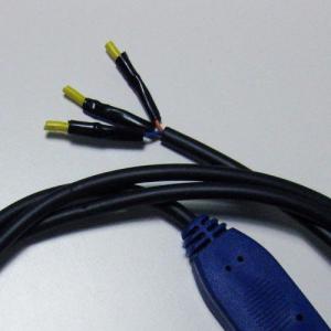

Hey, sorry guys, but I'm a bit of a newb with all the wiring business...
After I purchase a CA-42 cable, what materials or how would I need to modify it to be able to plug it into the SATA drive?
I can see that I'd basically need to chop off the cable and use the USB end, but how would I need to modify the wires to plug them into the GND/RX/TX? Is any soldering required for this part?
I soldered thicker wires (the yellow bits in the picture, wrapped with electrical tape) to the end of the thin wires, they can then plug into the GND/RX/TX pins, everything is insulated and works nicely.
