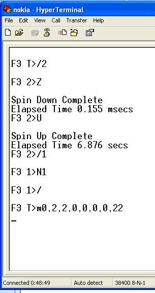

Hi everybody,
I have a 7200.11 ST3500320AS (firm SD15) with BSY error :}
At first I tryed to replace the PCB by an other ST3500320AS --> not recognized by BIOS...
Then I tryed the gradius solution:
/2
Z (Spin Down Complete Elapsed Time 0.147 msecs)
With the POWER CONNECTED to the PCB board I mount the board back on the HDA case
U
I hear the motor and 7 min after I have the same message:
(I use a power sullply +12V-4A +5V-5A)
why it doesn't work?
Thanks

@ filippode2
1. Changing the PCB ist not recommended, because of incompatibilities: geometrical data of the disk is programmed into the PCB. Booting the Disk with an incompatible PCB can cause severe damage to the read/write heads. :thumbdown
2. I hope, that this is not the case. Then the Read/Write error seems to me a problem caused by bad contacts on the motor or Head connector. What I recommend before executing the commands: Unmount the PCB completely and clean all contact areas of the PCB. These are the contacts for the motor and the contacts for the read/write heads. I used a rubber erasor and it worked fine. Often the contact areas are a little bit oxidized exept at the spot where contact is made. If, by unmounting the PCB you shift this point of contact, you only get a partial contact and this can be really bad.
So try it again and look, what I have discribed in my post in the previous page. :)
Good luck.

Hi guys, I tried the process in order to solve the BSY error I have with my Seagate HD. I got till the step where I need to write the
F3 2>U
and then I didn't manage to get any thurther. I didn't get any message after that. Did somone encounted with the same problem? Is there any way to solve it and move thurther with the fix?
Hi to all
tnx for your soloution,i did all your set but when i bring back the pcb to the HDA , the hyperterminal program hangs and i cant type (u) to spin up the hdd .
how can i solve the problem ?
i tried this method on five diffrent HDDs but all of them hanged.
tnx for ypur soonest response .

I just brought my ST3100034AS with SD15 firmware back to life today thanks to this guide. It had the infamous BSY problem. Yeah, I know, I'm late. Had it die way back on Boxing Day 2008. First I had a dud USB to TTL adaptor, so I gave up for a while. Eventually I decided to play it safe and bought an RS232 to TTL adaptor as then it's all native. The only computer I had lying around that had an RS232 port was my old 500 MHz Pentium III from way back in 1998. I was about to give this thing away, but it seems it proved its usefulness after I fired it up for the first time in years. Yeah, the level of improvisation one has to make in order to fix this drive is quite amazing. :P
I didn't really have much equipment around and there weren't many shops nearby selling much more than jumpers, so I bought a load of jumpers and decided to use them a bit like headers. Then I connected it all up. The TX from the adaptor went to the RX on the hard drive, and RX from the adaptor to the TX on the hard drive. I also used a 3V battery to power the adaptor because I didn't like the idea of chopping up my SATA cables. And of course, I wedged in a piece of card to separate the motor contacts. After plugging the SATA power cable to the hard drive from my main computer's PSU, the terminal session was all good to fire up.
A couple of minutes later and the Seagate booted happily as if nothing ever went wrong with it. Everything was there the way I left it. So in other words, another epic success story. :)
So yeah, a BIG THANK YOU for saving me from the black hole aka Seagate 'service'. You guys are awesome! Now proceeding to update the firmware... :)
EDIT: Firmware updated to SD1A, it's all good. :D
