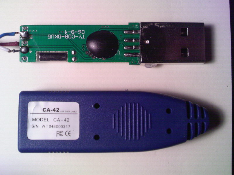

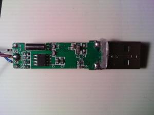

Hi to all.
I just fixed my drive thanks to CarterinCanada.
I used a CA-42 data cable for nokia.
Here are some pics of the cable I used.
1 - green - not used
2 - black - gnd
3 - red - +5V (not used) the kit takes power from the USB connection
4 - white - TX
5 - blue - RX
Any one in the Greater Montreal Area who have fixed the problem or are suffering the problem, I have two drives affected.

With nokia cable:
nokia cable use
BSY solution:
BSY fix
Thank you very much for all your work!
Edited by gallyfa
