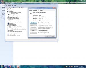

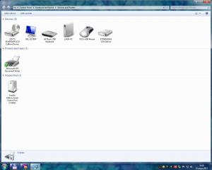

Hello.I've successfully unbricked my HDD from BSY state.After trying three times with a Nokia CA-53 cable I've decided to buy the famous CA-42 one and it worked.
My HDD is ST3500320AS firmware SD15(bought in december 2008) and the nokia cable's code is WT048000317.Thank you guys.Oh and I've added two screens with the driver that Win7 installed when I plugged in the cable.Thanks again.
post-325580-0-59455900-1307123921_thumb. post-325580-0-34406200-1307123935_thumb.

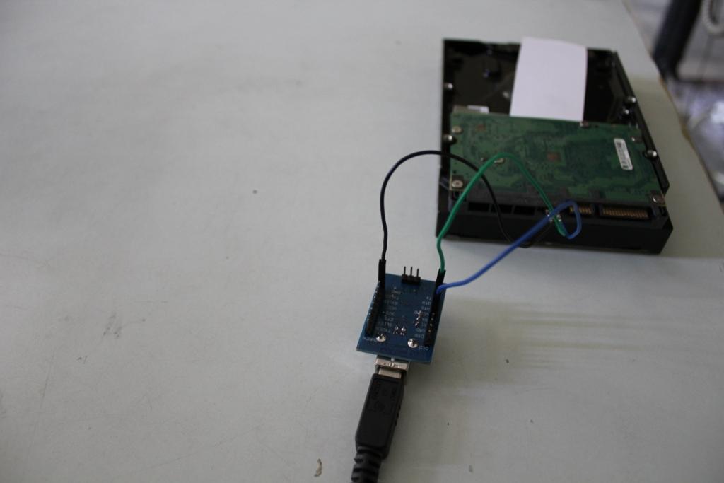

Hi,
I am using a USB to TTL adapter for the purpose. I did a loopback test and the results were positive. Now when I connect the Tx to the Tx, Rx to the Rx and Gnd to Gnd, and press Ctrl Z, this is what I get..
post-310776-0-22367000-1307172487_thumb.
I also tried changing from Rx to Tx on the adapter but no result with that as well.
I have also attached pictures of my set up.. Please let me know if I need to make any changes.
post-310776-0-38451600-1307172675_thumb.post-310776-0-73598100-1307172684_thumb.post-310776-0-06956600-1307172831_thumb.post-310776-0-14767000-1307172840_thumb.
Thanks in advance.
@104
Have you checked, double checked and triple checked the settings for speed/parity, etc?
That is point #9 of read-me-first:
I hope that the pictures are taken after you have removed the SATA power connector for the disk that WAS there (and powered) when you attempted the Ctrl+Z. :whistle:
