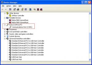

Visualize Posted August 8, 2009 Posted August 8, 2009 The usb-contact should contain some kind of circuit with some ic´s on it.Your usb-contact looks like a third-party assembled cable and looks completeydifferent from mine. However, i can´t say it won´t work but i doubt it.When you connect the cable to the computer, does the computer detect it as a new hardware?If not, the chances are that is just a straight-thru usb-cable with out any circuits inside.I can post some pictures of mine genuine cable tomorrow afternoon.Hey thanks for reply, The ca-42 cable i have was for nothing a friend gave it to me but now i have a Nokia dku-5 but it doesn't show up as new hardware when connected to usb port(device manager screen shot attached) either. I remember when i used to connect my N70 then only it used to show as new device.Based on the below links it seems i would not have to cut the cable, correct me if I'm wrong http://pinouts.ru/CellularPhones-Nokia/nok...op_pinout.shtmlhttp://pinouts.ru/CellularPhonesCables/nok...le_pinout.shtml

jaclaz Posted August 9, 2009 Posted August 9, 2009 ^^ I owned a N70 and the dku-5 cable came with it... there's no question of uncertainty being real or fake I lost your current situation. The dku-5 cable worked for you?captain0mikehttp://www.msfn.org/board/index.php?showto...807&st=1058reported that it didn't work with his laptop, only with "desktop PC":2. DO NOT USE LAPTOP with dku-5 cable,I did not get any connection in hyper terminal. DO USE desktop pc instead. the laptops wasted my whole night. http://www.msfn.org/board/index.php?showto...mp;#entry855465Then you tried a (supposedly "no-name") CA-42:http://www.msfn.org/board/index.php?showto...mp;#entry873903and it didn't work as well, correct? jaclaz
