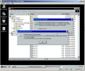

A bit more basic presumably. I borrowed an old Visual C++ 6.0 cd and installed that on a clean VirtualBox install. After installation WFP kicks in. As you can see i mounted the HFSLIPCD but it's not accepted. Is it searching for the cd key here? Nice "Insert your now." message BTW.
Your 8g fileset also works great with latest HFs on an NLD install. It had under Display Props, Background both (Geen) and (None) with (None) having the bitmap icon. This disappeared after a second reboot, not counting the reboots during install. Much like %ASTERISK%.
You know, to be honest, it's a message I have always dismissed. I never knew that it didn't work.
Not sure what's going on. I'll have to check into it. I'll have to do a regular install and monitor the file replacement with some tools to see what's being called.
I have fixed this.
Sorry about this! One of the ways I got the message cleaned up was to set the SFC path, and the install path, as the same. The lines below make it work now.
HKLM,"SOFTWARE\Microsoft\Windows NT\CurrentVersion\Winlogon","SfcQuota",0x00010001,ff,ff,ff,ff
HKLM,"SOFTWARE\Microsoft\Windows NT\CurrentVersion\Winlogon","SFCDllCacheDir",,"e:"
HKLM,"SOFTWARE\Policies\Microsoft\Windows NT\Windows File Protection","SFCDllCacheDir",,"e:"
HKLM,"SOFTWARE\Microsoft\Windows\CurrentVersion\Setup","SourcePath",,"e:"
Change "e" to whatever your CD-ROM path is. Mine now says "Insert your Windows 2000 CD" and recognizes the CD.

Posted (edited)
OK, a new iso with the four reg entries as in previous post, except I use d:. This is of course checked on the actual installation (regedit).
"When WFP kicks in" indeed the message is "Insert your Windows 2000 CD", I let the VCPP installation finish.
Then I unmount (Devices menu) VCPP.iso and mount HFSLIPCD. Clicking Retry gives "Insert your  now." again.
I'm doing something wrong?
EDIT: Just to see I didn't destroy anything I let setup create two partitions and use the HIVESFT provided. No, sorry, it's "Insert your  now." right after mounting the HFSLIP iso. Followed by 'Are you sure... unrecognized versions?'
EDIT2: I forgot: in both cases 'sfc /scannow' simply finishes the scan without complaining about anything 'unrecognized'.
I'm not clear on what you are triggering this event with -- which files are you replacing?
I don't understand why the "CD" goes away. I am stumped on this one. I set SFCQuota to ffffffff to save all files but somehow I guess it's not happening. I will check into this more but I can't promise a solution because "on paper," SFC should work fine...

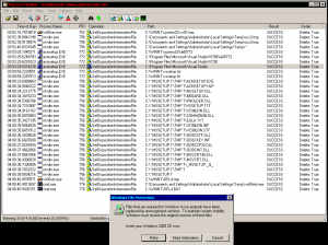

Posted (edited)
I'll try to find that out:
Using procmon with filters set as posted by hadouken at neowin.
1. "Detail" "contains" "Delete: True" (type it without quotes)
2. "Operation" "is" "SetDispositionInformationFile" (select from the drop down box)
The entry selected (grey) is where wfp pops up. Not much happening it seems.
Edited by Brabant

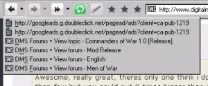

Martin, maybe you can help me with the following.
Newer Opera versions seem to remember too much. See the screenie. It makes me have to 'backspace' three or four times just to go back one page. Is there a solution to this?
Just noticed these advertisements show up in History like http://bdv.bidvertiser.com/bidvertiser.dbm...4130&..blah blah. I don't want these as 'visited urls'.
And I was wondering why addresses, only typed in a few weeks ago, weren't autocompleted anymore.
This shld be a separate thread but if you discover Opera is writing reg entries as opposed to updating some file, let me know, and I can write them in INF format and add them to MRU_KILL.INF.
