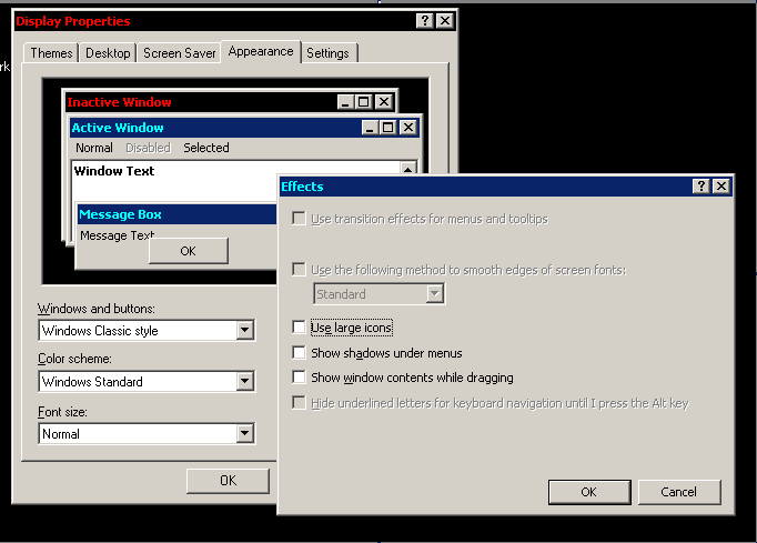

    Those three greyed out settings get enabled by changing HKEY_CURRENT_USER\Control Panel\Desktop\UserPreferencesMask from "00 00 00 00" to "b0 12 01 80", a value I borrowed from a non-fdv-xp install. I don't know yet if it breaks anything but these things can now be accessed. Now what's wrong with me %systemroot%\system and other paths? Edit: starting a cmd box and giving PATH gives PATH=C:\WINDOWS; ..etc.. in the non-fdv-xp box but gives PATH=%SystemRoot%; ..etc.. in fdv-xp Any ideas about this please?

    So I've got to use XP anyway... Chapa9ai Thanks for pointing to sfc_os.dll. It now installs faster and without this nonsense about things being unsigned. And the mofcomp error is not in the latest file set. A few things: I have bmp2png in the windows/system dir. But if I do c:\bmp2png it is an "unrecognized internal or external etc..." , so it can't find the path I'd say. In the environment variables there is %systemroot%/system and system32 and system32/wbem, all separated by colons. What's going on? The Effects (under Display Properties -> Appearance) are unavailable. See attached pic if it's unclear what I mean. Having ClearType is essential. Not sure if the following are sources of these problems but I ran this HFSLIP without any HFs to speed things up and I'm running XP in VPC2007.
