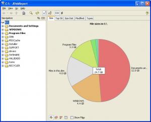

I attached the printscreen from JDiskReport. Total space that been used is only 24GB.

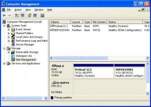

looks like you may have a hidden recovery partition.
is it a laptop? i think some desktops also have hidden partitions.
reason is you are showing your c: partition size to be 24.7 gb. the other space is either unpartitioned or in a recovery partition.
right-click my computer --> manage --> disk management
take screenshot and post here.

Below is the screenshot of my computer mangement.

Also, now I see that in your 5th post, the 24 gb is not the total capacity of your hard drive but it represents the used space. That means you have 70 - 24 = 46 gb free.
So question is, where is it reported that you only have 5 gb free? Right click on C: drive and post your properties page here.
If it is indeed showing only 5 gb free, definitely you got a lot of residual junk in your system and fresh install recommended for a faster system.
