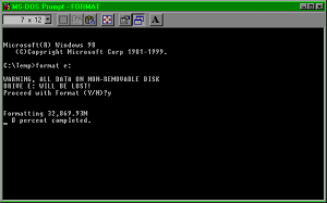

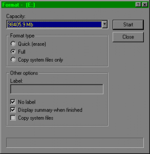

I just created a RAID 0 logical drive using HPT372 and 2 WD5000AAJB. I have 1TB of free space and no way to format it!
I just created a FAT32 partition with Ranish Partition Manager, saved it and rebooted. I was planning to format it form Windows, (Rightclick-Format...) but there is a problem. Windows tries to format it as a 98GB partition. FORMAT.COM - same problem.

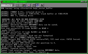

Fixed FORMAT.COM :(
FreeDOS FORMAT.EXE :(

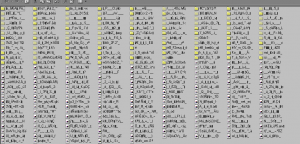

DK Lite results: a dir was corrupted.
