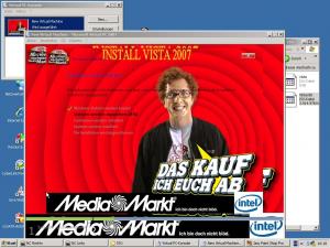

mediapla Posted November 20, 2007 Posted November 20, 2007 Thats very interesting.... Iwoudlso change my setup screens, but i didnt found the resources, So i play a little animation film during the first time of setup. Is it possible to have sound at the vista setup ? In the XP setup process it runs fine at T32...
mediapla Posted November 24, 2007 Posted November 24, 2007 Mhhh, i didnt found the setup wallpaper with resource tuner in this files.... Anyone knows more about the setup screens ?I changed the winpe.bmp, and the setp starts with my new wallpaper, but only a few seconds and "bam" ther was the old style on the screen...
mediapla Posted November 28, 2007 Posted November 28, 2007 :thumbupHi, i had (partially???) success !!! But Im a little bit confused. There are so much files inside and outside of the Wim Files, and i made my work at home and at workplace, so i dont remember, which files i had patched. I believe they had all the text string "img" in the filename, so you should look in this files for Images. Some had bmp,some png files inside. Im still testing...
