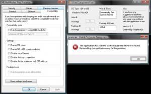

Pics
1st Pic > First pic as a preview probably when you first open the program and have both files missing.
2nd Pic > This pics shows faultrep.dll was fixed in a previous use of the program and wer.dll is when ive just cliked "Fix".
