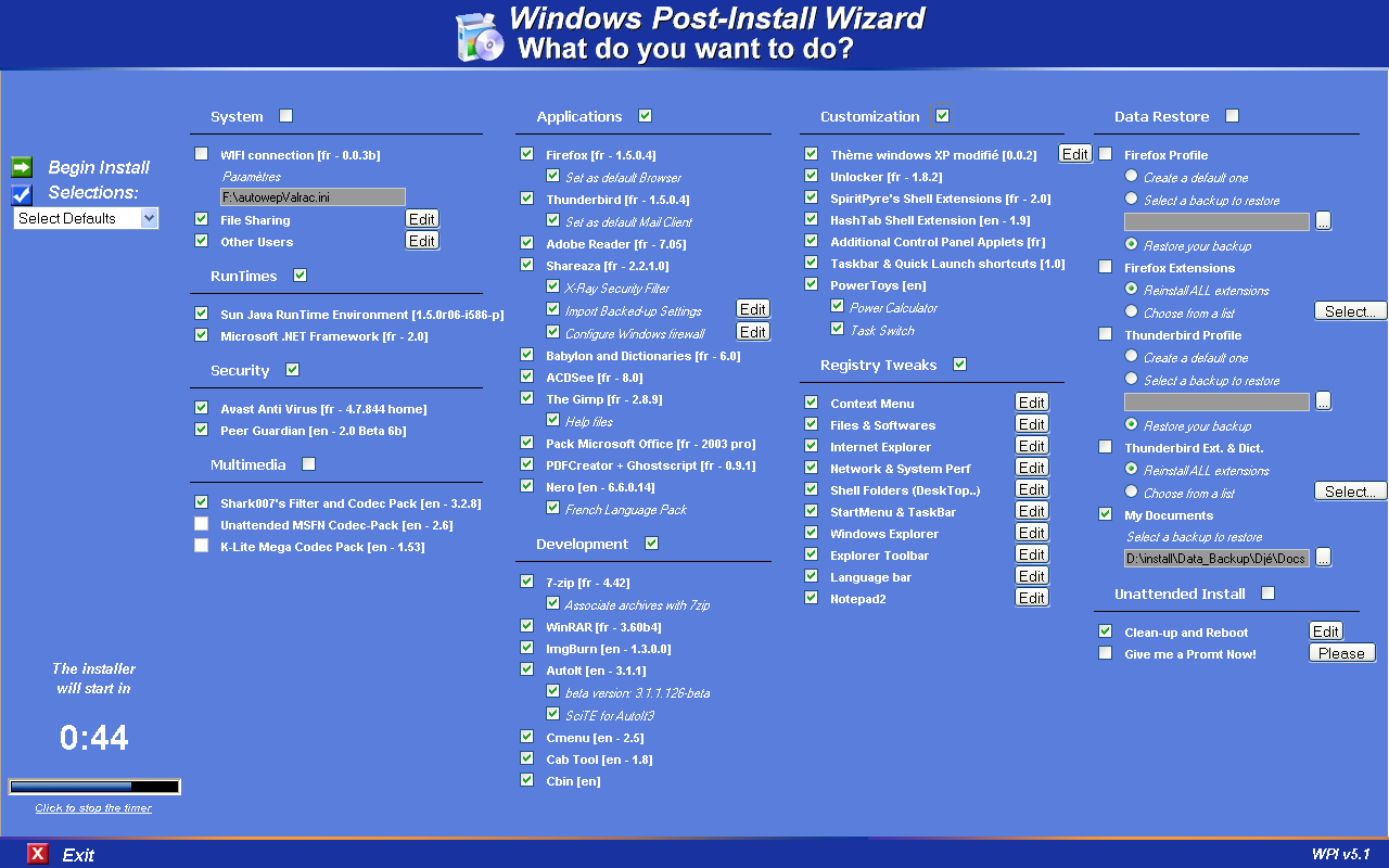

The mix is ready. Here's a glance at my full psychedelic hallucinations: This was achieved very easily using the injection functions in my Excel Progs Lists Manager, which is designed to maintain and write WPI's config.js files as well as progs lists in other formats (RunOnceEx, kTool, WIHU, XPLODE). The last version of the manager is geared toward WPI (v5.1), with easy managment of Exclusions & Dependancies, UserOptions, Default Selection ... and Injection! In the ProgsList Manager, for documentation about the injection functions, look at the textbox at the bottom of the "Djé's" Progs List. The issues mentioned in the previous post are solved. Of course. And the functions' syntax is easier than what was expected at that time.
