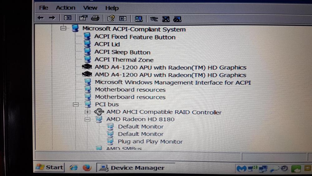

  18. I used SDIO to find the touchpad drivers, there were a huge number of options from many PC manufacturers, a huge package to download, and while I didn't try all of them as it would have taken many hours, I didn't find a single one that actually worked properly of the ones I did try. They all install, but none produce a usable control panel so you can't actually change any settings. Either the control panel is completely blank, or only a few settings are shown, none of which actually work. As far as I'm concerned, the touchpad is unusable unless the "tap to click" function can be disabled at very least. How people use them with that switched on is quite beyond me, the constant unintentional clicks drive me mad! I suspect the touchpad on my machine is designed only to work with Asus Smart Gesture, which has no version that will install on XP. I also found a lot of chipset drivers, but again, none of them will work. Most of them are 64 bit, as it's a 64 bit machine. None of the 32 bit versions have information about the hardware. As for the graphics driver, I don't think the option to uninstall/reinstall it on every boot will work either, quite apart from the fact that it will horribly slow down the process! I've done more experimenting, and if I disable the display adapter so I can boot into normal mode, and then enable it, it enables OK, but is still shown as being in 640x480 mode in the Display Properties. As soon as I change that it tries to change the resolution, and then BSODs. I can't imagine that the same thing wouldn't happen if it was being installed on every boot. Fundamentally, it's not communicating with the hardware properly, and even if it could be got to work as it should even the once, I suspect it would always be very unstable. No, I think the time has come to admit defeat here, and accept that some things just aren't possible with XP now.

  21. Thanks @jaclaz. Yes, I could just try it with the VGASAVE driver for a while and see how it goes, although I'm sure I will find the slow refresh rate (even with acceleration level 5) vary annoying! Still, as you say I'm only using it as a secondary OS really just for diagnostic purposes on Windows 8.1, so maybe it won't matter. Does "Qres" provide the same functionality as "MultiRes"? They look very similar. I already use "MultiMonitorTool" on my desktop, it's a great program, as all of Nir Sofer's are of course! His "SetDisplay" tool seems to be another resolution switcher. I don't actually need anything like that with the VGASAVE driver as I appear to be able to set the resolution levels using the normal Display Properties window.
