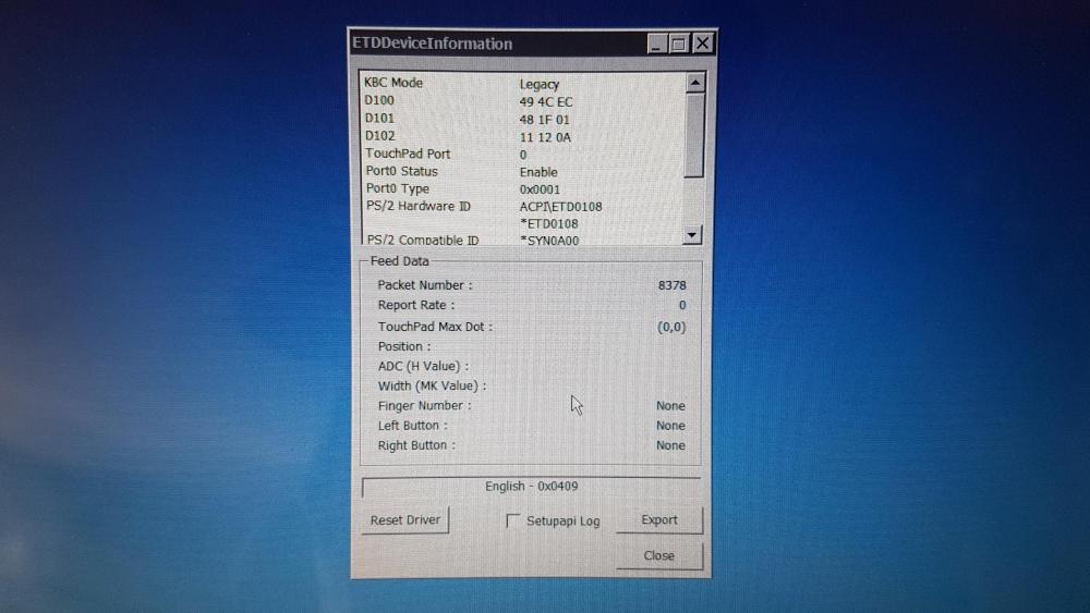

OK, I replicated what was done on 8.1, the only difference being that 11.5.20.3 had to be installed via the INF in Device Manager, as the setup won't run on XP of course. I substituted the files from the Elantech folder of the working driver on 8.1 into the equivalent folder on XP, and substituted ETD.sys as well. So, it should now be a replica on XP of what's on 8.1. It still doesn't work though, the touchpad is dead and Device Manager says the driver is missing or corrupted. Only ETDCtrl.exe is running in the background, nothing else relevant. If I run ETDCtrlHelper.exe, it says UnregisterPowerSettingNotification could not be found in USER32.DLL. I seem to remember that daniel_k had a fix for that, a powrprof.dll to put in the Elantech folder. The main thing missing seems to be the service, which is in the Services list on 8.1 as "Elan Service". It's not there in XP, but that may be because the routine for installing a service in 8.1 is different to XP? Just guessing here! I exported the 8.1 registry settings for the service and imported them into the XP registry. The service is now there, and is running. I put the pwrprof.dll into the folder, but it hasn't got rid of the problem with ETDCtrlHelper.exe. I think that needs to be running. The Device Manager is still showing a yellow exclamation mark......

OK, I gave it a try, but no joy I'm afraid. I had to install directly from Device Manager as the setup.exe isn't XP compatible. It apparently installed as an "Elan PS/2 Port Smart-Pad", but it just produced "the driver is missing or corrupted" in Device Manager after reboot. The Elan tab in the Mouse properties is back but blank. Only ETDCtrl.exe is running in Task Manager, not the Elan Service. There is no system tray icon. ETD.sys is the same version now on XP as it is on 8.1 (11.122.4.7) but it seems to be producing a different result. For instance there is no Elan tab on the Mouse Properties in 8.1. I think that initially installing 11.5.20.3, which is an Asus driver, and then replacing its files with Elan driver ones, has ended up with a different result to installing the same files as an Elan driver in the first place. Do we need to somehow install 11.5.20.3 on XP and then change its files like on 8.1?

OK, I replaced all the exe and dll files except ETD_DLL.dll, ETD_Aniconf.exe and ETD_Api.dll with the versions from the Lenovo driver (which actually appears to be version 11.4.36.1, not 11.4.38.2). It still worked fine, even the Asus hotkey still worked. I then replaced the three files I didn't replace the first time, and the driver still works fine, but the error message now comes up again from ElanTPCfg.exe, and the hotkey no longer works. There must be something in one of those three files it doesn't like! The versions i have running now are - ETD_DLL.dll 11.10.0.0 ETDAniConf.exe 11.40.4.2 ETDApi.dll 11.5.0.0 ETDApix.dll 11.27.4.1 ETDCmds.dll 11.29.4.1 ETDCtrl.exe 11.41.4.3 ETDCtrlHelper.exe 11.15.0.0 ETDDeviceInformation.exe 11.143.0.0 ETDFavorite.dll 11.11.0.0 ETDMcpl.dll 11.18.0.0 ETDService.exe 11.8.0.0 ETDUn_inst.exe 11.4.0.0 ETDUninst.dll 11.1.0.0 I had a bit of a problem getting at the actual files for the Lenovo driver, as it's an exe, not a zip. 7-zip didn't help, but good old Universal Extractor did!

OK, I reinstalled 11.5.20.3, and it was working fine. I then substituted all the exe and dll files that were in 11.2.2.1 for their equivalents in the Program Files\Elantech folder. It still works! The only thing that popped up on boot was that ElanTPCfg.exe had performed an illegal operation and had to be closed, but the driver is still working. That's a bit of a breakthrough I hope!
