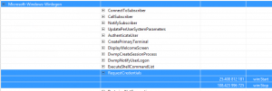

  6. RequestCredentials takes too long. Do you use a Microsoft online account?

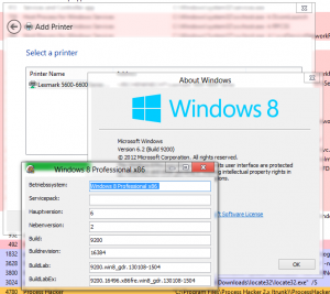

  14. use ProcessExplorer and use the "Find Window" icon in the toolbar, drag the cross hairs on the messagebox and you see that it comes from csrss.exe.
