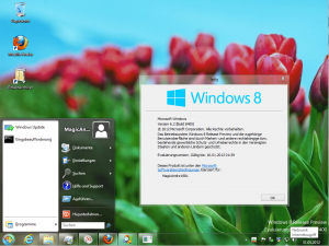

  1. yes look at the Buildnumber. 8400 = RP. Paul Thurrott wants traffic for his site? I don't know.

  6. ClassicShell still works:
