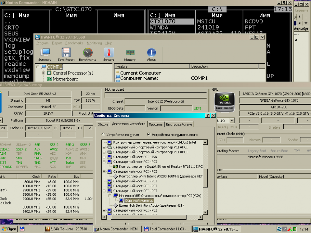

  10. Huanazhi X99-TF (C612 chipset) Intel Wellsburg PCH - High Definition Audio Controller [B1] PCI\VEN_8086&DEV_8D20&SUBSYS_72708086&REV_05 RealTek ALC887 HDAUDIO\FUNC_01&VEN_10EC&DEV_0887&SUBSYS_10EC0887&REV_1003 hda.sys driver is loaded, no crashes, 9x system see audio device, try play, but no any sounds. on win10 with standart hdaudio.sys sounds ok.

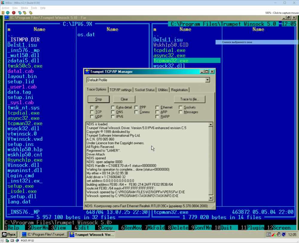

  12. possible i already solved this "problem"... patch for Vtwinsck.vxd SIZE 179861 DATE 5.May.2004 CRC32 5c32ece0: 2741C: A9 01 00 00 00 -> 33 C0 83 C0 01 but i am not sure, that it was so simple... i cant check, is it work properly, or not. and anyway, it crack all winsock subsystem... my "9x" is 98IF, and too "updated" for this thing. so this is useless.
  13. no, it is absolutly useeless and unusable thing... — it crack Kerio Firewall, — it crack all system network utilites (ping, ipconfig, winipcfg, ...) — it is constantly "expired".
