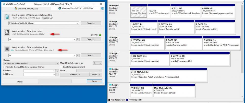

Thank you for the new version 4.5.0 Beta 2 In general one can say that WinNTSetup 4.5.0 Beta 2 in normal use is working OK now However in some cases VHD Create fails to assign drive letter to the new Fixed type VHD. Also I tried to use the New Created Fixed VHD's for booting in UEFI mode from RAMDISK using UEFI Grub2 Or UEFI Grub4dos and using signed SVBus driver. It turns out that the Fixed VHD's created and Applied with WinNTSetup are not compatible with UEFI RAMOS booting, probably since VHD internal EFI folder is missing ... For UEFI booting from RAMDISK the most compatible VHD is Fixed VHD with MBR 2 Partitions (Active FAT32 100 MB + NTFS) containing VHD internal Boot and EFI folder ONLY on FAT32. Fixed VHD with MBR 1 Partition NTFS can be used but must contain UnCompressed Boot and EFI folder for booting with MBR Grub4dos and UEFI Grub2 / UEFI Grub4dos. The WinNTSetup Created VHD has 4096 hidden sectors instead of 128 hidden sectors in case of VHD created with diskpart, The WinNTSetup Created VHD is compatible with VHD_WIMBOOT and after Apply in VHD_WIMBOOT then the VHD can be used for UEFI RAMOS booting.
Fragmentatition does not matter with SSD, but fragmentation can matter for booting when VHD file itself is fragmented .... UEFI RAMOS requires Fixed VHD.
I think Fixed VHD is preferred and should stay as recommended. - Dynamic VHD will as it grows gradually results in fragmentation of the VHD file itselves which is undesired behaviour. - Fixed VHD is needed for the very new UEFI booting from RAMDISK using UEFI Grub2 and UEFI Grub4dos
That is not the point that my remark was about. My point is: (probably due to the fact that my normal OS is running in VHD instead of partition) Just when I start WinNTSetup then the hidden EFI drive of GPT partitioned disk is Not automounted anymore as drive Z: and the Boot Drive is not autoselected as that drive Z: anymore. This has nothing to do with creating VHD. In my case I have OS in existing VHD located on GPT SSD with Hidden EFI drive as Boot Drive Also In Create VHD the Fixed size (recommended) option is not preselected as default option anymore.
Hidden EFI drive is not automounted anymore in 4.5.0 Beta 1 That means it is not easy to select the Boot Drive for install on GPT partitioned disk. Previous versions auto give Boot Drive is Z: as the automounted hidden EFI drive. In Create VHD the Fixed size (recommended) option is not preselected as default option anymore.

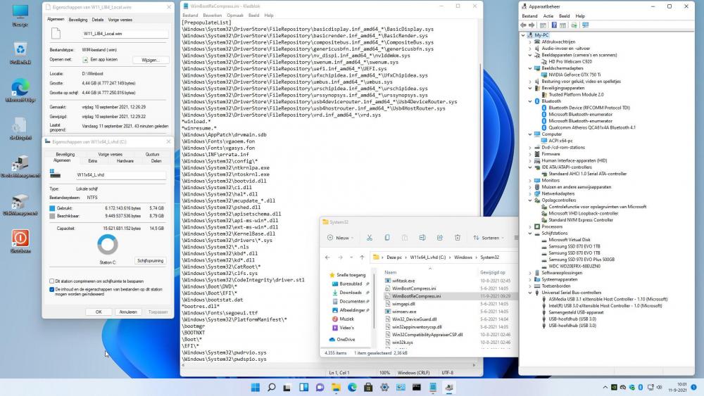

OK thank you for WOF Status report. removal of EFI folder requires Trusted Installer, but renaming of EFI folder as x-EFI can be done as Administrator. The EFI folder inside VHD is already created by WinNTSetup and cannot be removed simply. VHD_WIMBOOT Capture and Apply will prevent WOF Compression of EFI folder inside VHD when new WimBootCompress,ini is used as present in VHD_WIMBOOT-43 What I can do is to modify UEFI_MULTI and VHD_WIMBOOT so that in case of 2 Partition VHD that EFI folder is not made in NTFS partition and when present is renamed as x-EFI. I think this can solve the problems encountered with EFI folder in NTFS partition of 2 Partition VHD's Also new UEFI Grub4dos version will be used, but give me some time to realise it ..... May be reboot.pro will be a!ive soon .... I mean of course alive .... I see that you often speak of grub32.efi whereas it is grubia32.efi ......

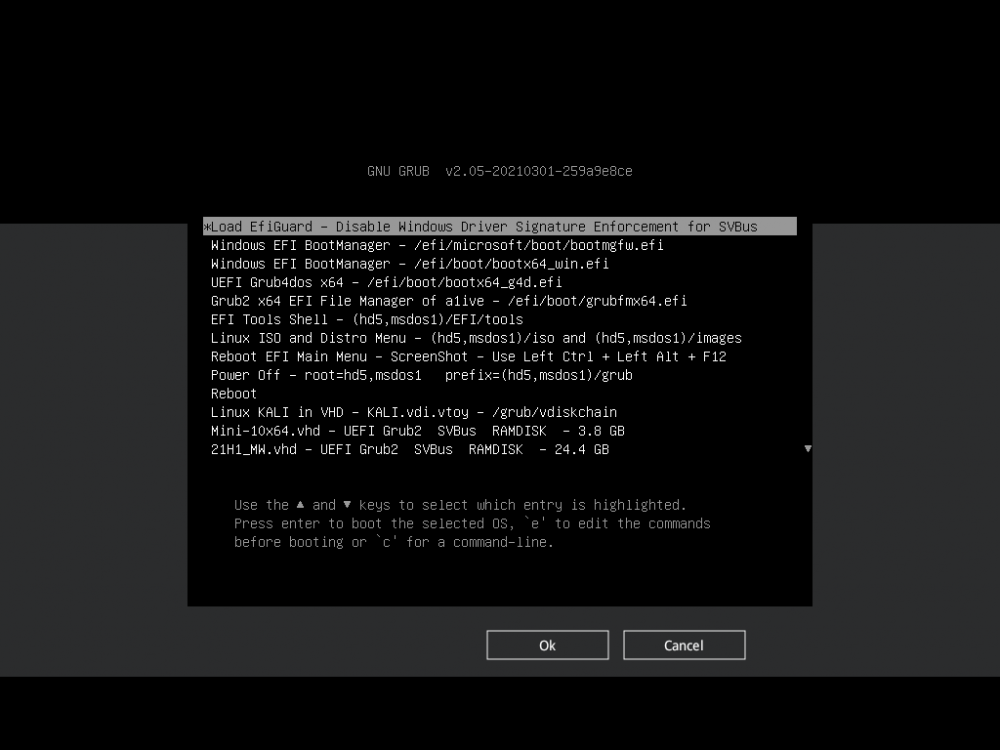

Update USB_FORMAT-54 and UEFI_MULTI-55 plus the Addon-agFM files Download: from GitHub USB_FORMAT-54 and UEFI_MULTI-55 Download File E = Encrypted Password = bootwimb Manual: VHD_WIMBOOT.pdf - Added UEFI Grub4dos and a1ive UEFI Grub2 for UEFI booting VHD from RAMDISK - Use Super UEFI setting for UEFI Secure booting - Added signed SVBus driver for UEFI booting VHD from RAMDISK - Checkbox Add Grub2 System Folder (Often Unneeded - Unchecked saves Copy time and space for 1000 files 12 MB) - UEFI_MULTI - Added WofCompress of JFX to UnCompress EFI folder inside VHD when Making Boot entries - EFI folder in VHD needs to be UnCompressed in case of UEFI booting 1 Partition VHD from RAMDISK - UEFI grub4dos version 2020-12-26 - in case of 2 Partition VHD then EFI folder is not made in NTFS partition and when present is renamed as x-EFI In my case ntfs_x64.efi driver is not needed anymore for UEFI booting of 1 Partition VHD from RAMDISK using UEFI Grub2 Or UEFI Grub4dos The boot problem of 1 Partition VHD was entirely due to WOF Compression of EFI folder and this problem is solved now Credits and Thanks to: - a1ive for making UEFI Grub2 and Grub2 FileManager - yaya2007 and a1ive for making UEFI Grub4dos - alacran for help and support - liuzhaoyzz for help in solving boot_image_handle not found problem in case of UEFI Grub4dos More Info: at reboot.pro Forum VHD_WIMBOOT and Grub4dos for UEFI and USB_FORMAT and UEFI_MULTI ==

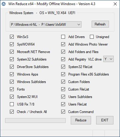

1. WinNTSetup - Fresh Install in 25 GB Fixed VHD located on internal SSD / Harddisk using Win10x64 ISO from TechBench 2. VHD_WIMBOOT - Capture WimBoot LZX and Apply in Compact LZX mode in Fixed VHD 10 GB - Offline Windows 3. Mount VHD with doubble-click and use Win_Reduce_Trusted on Offline Windows - Reduce in 1 minute gives Mini 10x64 VHD UsedSize = 1.79 GB - Capture WimBoot LZX WIM = 1.19 GB and Apply Compact LZX in 3.9 GB Fixed VHD with MBR 2 Partitions 4. Boot with 3.9 GB VHD as FILEDISK using Windows Boot Manager menu - Always use the supplied Firewall App Blocker and Enable WhiteList to Allow Internet Browser only - This is the easiest way to block unwanted internet traffic including Windows Update and prevents the growth of Used Size inside VHD 5. Install signed SVBus driver in running Windows of 3.9 GB VHD - needed for UEFI booting from RAMDISK - Install SVBus EVRootCA Registry Fix in runnung Windows - use SVBus-signed_2 folder - Install SVBus Driver as Admin - use R-mouse on instx64.exe in SVBus-signed_2 folder - Reboot VHD first as FILEDISK from Windows Boot Manager to make Install of SVBus driver effective - Reboot with your normal Win 10x64 operating System 6. USB_FORMAT - make portable USB SSD with MBR and 2 partitions (FAT32 + NTFS) 7. Copy 3.9 GB VHD to NTFS drive of USB prepared with USB_FORMAT 8. UEFI_MULTI - Select FAT32 Boot Drive and NTFS System Drive of USB - Select Super Grub2 as Boot Manager and Select the Mini 10x64 3.9 GB VHD copied to NTFS drive of USB - use GO to Add VHD 4x as Menu Entry for booting with UEFI Grub2 and UEFI Grub4dos and Windows Boot Manager (MBR Boot and UEFI) and MBR Grub4dos 9. Reboot and use F8 menu to Boot from USB in UEFI mode with Grub2 Or in MBR BIOS mode with Windows Boot Manager - Select to Boot Mini 10x64 VHD 3.9 GB from RAMDISK in UEFI mode using SVBus driver - Or chainload other menu's -
New from a1ive UEFI Grub2 that can be used for booting Mini10 VHD from RAMDISK. Download: latest Grub2 of a1ive has support for svbus More Info: UEFI Grub2 at reboot.pro in Grub4dos for UEFI topic In Admin Command Window use Diskpart to make VHD which needs to have MBR and 2 partitions - 100 MB FAT32 + rest NTFS create vdisk file="D:\VHD\Mini10_SV.vhd" maximum=3900 type=fixed select vdisk file="D:\VHD\Mini10_SV.vhd" attach vdisk create partition primary size=100 format quick fs=fat32 label="EFI_VHD1" assign active create partition primary format quick fs=ntfs label="Mini10_SV_VHD2" assign list vol exit Signed SVBus driver from a1ive is needed to allow using grub.cfg menuentry - Password=reboot.pro otherwise grub2 commands must be used and allow unsigned SVBus driver by F8 menu UEFI grubx64.efi located in EFI\Boot expects as configfile \boot\grub\grub.cfg EFI\Boot folder according to UEFI_MULTI-50 with UEFI_MAN\efi\Boot where grubx64_real.efi is replaced by new a1ive UEFI Grub2 file Grub2 command to get menu configfile /boot/grub/grub.cfg Grub2 menuentry in grub.cfg menuentry "Mini10_SV.vhd from RAMDISK" { map --mem --rt (hd0,gpt2)/VHD/Mini10_SV.vhd boot }

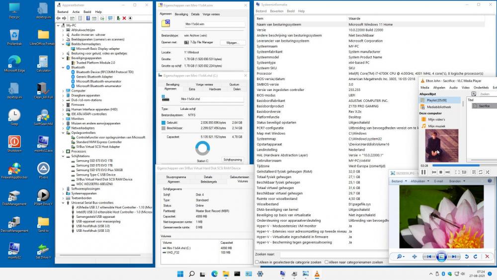

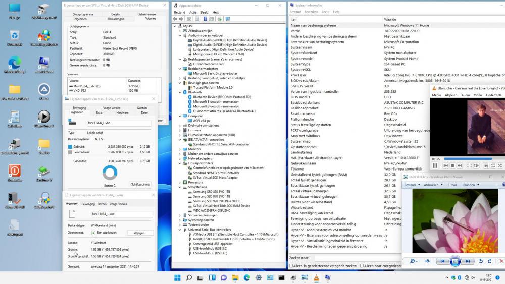

Mini_10x64.vhd is booting as FILEDISK from USB in UEFI Secure and in MBR BIOS Legacy mode also when located on Ventoy NTFS drive using ventoy_vhdboot.img VHD of 3.9 GB has UsedSize = 1.75 GB
