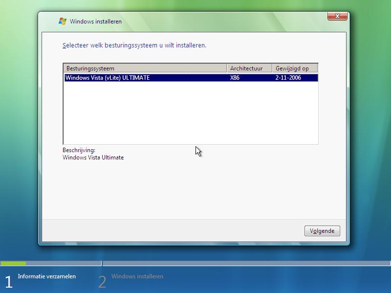

Is there a way to install my windows vista ultimate without choosing a os in the menu?
I made (with the help of the AutoUnattend.xml in the stickys) an AutoUnattend but somehow i always get the schreen that ask wich os i want to install.
I add my AutoUnattend.xml and a screen of the page that i dont wanna see again :angel

You will need to specify the metadata to install from like below if you are installing a modified VLite image value 1 is the one you need here.
 <InstallFrom>
<MetaData wcm:action="add">
<Key>/IMAGE/Index</Key>
<Value>1</Value>
</MetaData>
</InstallFrom>

Ok thnx i gonna try it out right now
edit
yeah that did it ^^ thnx a lot
