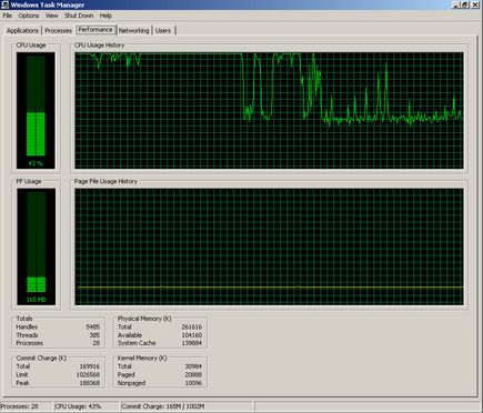

ok, im a little afraid of this computer overheating right now, because i'm seeing a steady 100% CPU usage, and i dont know whats causing it.
thats when it started to go down, but now its back at 100%

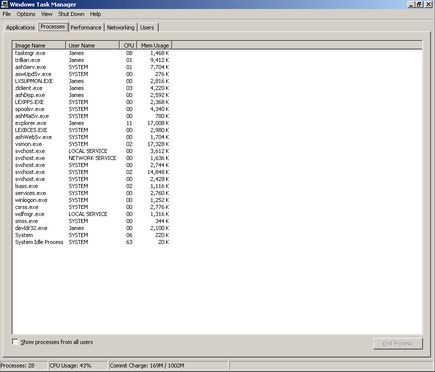

those are the processes running at the time.
its still way up there, any ideas as to whats causing it?
When did this start happening? Have you made any changes to the system before this occurred? I would strongly suggest using Process Explorer (from sysinternals) to take a look at CPU usage above and beyond what Task Manager is showing, so we can at least learn what process is utilizing the most CPU time. We can go from there, but we need that information over the course of a few hours.

What processes in the task manager are consuming the majority of the CPU?
can't say for sure what made that happen. i put in my ATA/66 PCI card, had my DVD+RW drive going into it, and when i turned this thing on, it said it had some problem booting, so i turned it off, took out the drive and PCI card, then rebooted. it then gave me an error on reboot about an error with my PCI ethernet card. i didn't want to go through too much bs, so i let it go and continue booting normaly. it started correctly, but the processor usage was very heavy, lowest of 38%, highest 100% and sometimes it held a steady 100% for a few minutes.
the problem ended, but i found three processes that used lots of CPU, and they are:
svchost.exe - 14,848K
explorer.exe - 17,008K
vsmon.exe - 17,328K
it took my computer a very long time to load things on boot when it happened..mostly the internet connections, and firewall. avast and audio started somewhat quickly.
the only programs i had running were cpu-z, to moniter my clock speed and voltage so i'd see if it went too far over [and it did several times] and trillian, to talk to amanda :wub: [very long story] and then task manager to watch usage.

can't exactly compress them without killing the quality...the object is to be able to see whats being showed...i posted the highest numbers that stood out in the list. everything else is normal.

VSMON.EXE ... ZoneAlarm firewall?
Try disabling that and see what happens.

Check whether or not your drives are running in DMA mode or PIO mode. If they're in PIO mode, set them to Ultra-DMA and reboot the computer. If that doesn't stick, then uninstall the IDE controllers and reboot again. PIO access can be quite CPU intensive and bring your system to a crawl.
