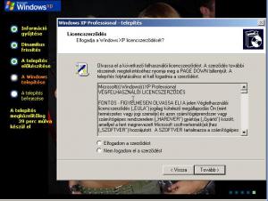

mandrake83 Posted September 2, 2006 Posted September 2, 2006 Hi everybody!I want to make a FullUnattanded XP CD, but one thing is wrong and the CD isn't FullUnnatended.So my problem is: the beginnig of the installation, XP shows the "License Argument" and I must click "I agree the license"... How can I switch of this window..or how can I make this method automatic. Here is my winnt.sif, it's works fine, but the License window is still there....Please help me!Winnt.sif:AdminPassword=*EncryptedAdminPassword=NOAutoLogon = "Yes"AutoLogonCount = 1TimeZone = 095OEMSkipRegional=1 OemSkipWelcome = 1

mandrake83 Posted September 2, 2006 Posted September 2, 2006 No!!! I said the license argument in the T-37... See the attached file...How Can I skip this window??????

Ctrl-X Posted September 3, 2006 Posted September 3, 2006 No!!! I said the license argument in the T-37... See the attached file...How Can I skip this window??????No need to shout! First of all, you never mentioned T-37 in your post. Second, you didn't post your entire winnt.sif file, so there was no way of knowing what's in it and what isn't.
mandrake83 Posted September 3, 2006 Posted September 3, 2006 (edited) No!!! I said the license argument in the T-37... See the attached file...How Can I skip this window??????No need to shout! First of all, you never mentioned T-37 in your post. Second, you didn't post your entire winnt.sif file, so there was no way of knowing what's in it and what isn't.Sorry CTRL-X! Here is my full winnt.sif:;SetupMgrTag [Data] AutoPartition=0 MsDosInitiated="0" UnattendedInstall="Yes" [unattended] OemPreinstall=YesUnattendSwitch="yes"TargetPath=\WINDOWS OemSkipEula=1[GuiUnattended] AdminPassword=*EncryptedAdminPassword=NOAutoLogon = "Yes"AutoLogonCount = 1TimeZone = 095OEMSkipRegional=1 OemSkipWelcome = 1OemSkipEula = Yes[userData] ProductID=FullName="Username"OrgName="Company"ComputerName=HOME[identification] JoinWorkgroup=WORKGROUP [Networking] InstallDefaultComponents=Yes [Data]AutomaticUpdates = No[Display]BitsPerPel = 32XResolution = 1024YResolution = 768VRefresh = 60AutoConfirm = 1And it still don't works. What can I do for automatic agree the License argument? Edited September 3, 2006 by xper
blinkdt Posted September 3, 2006 Posted September 3, 2006 Takeshi is correct. It should read:OemSkipEula=Yes...vice 1.
Takeshi Posted September 3, 2006 Posted September 3, 2006 This is incorrect:[unattended]OemSkipEula=1[GuiUnattended]OemSkipEula = YesIt should be:[unattended]OemSkipEula = YesRead and follow the guide/ref.chm carefully.
