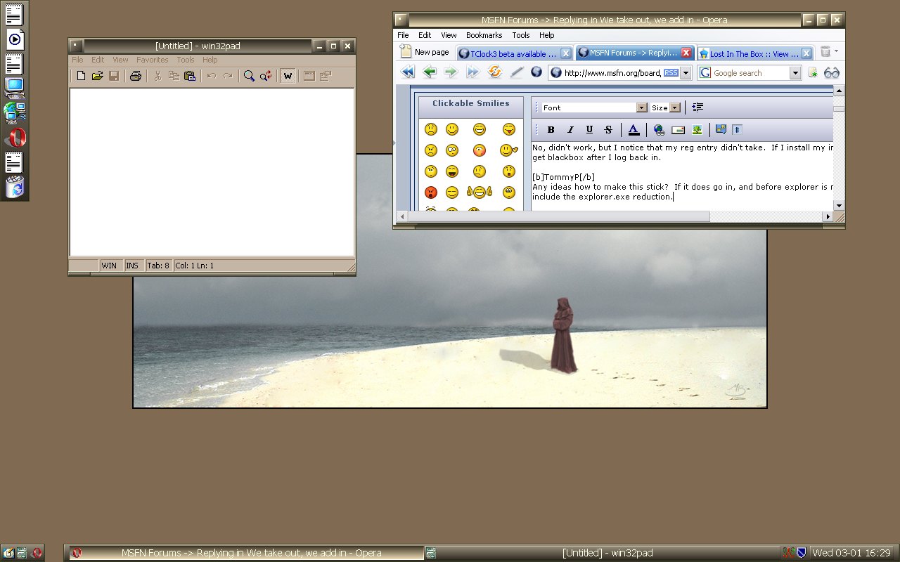

Squeeto Posted March 31, 2006 Author Share Posted March 31, 2006 No, didn't work, but I notice that my reg entry didn't take. If I install my inf file inside the virtual box, I do get blackbox after I log back in.TommyPAny ideas how to make this stick? If it does go in, and before explorer is needed, I may still be able to include the explorer.exe reduction.The background pic is probably being displayed without the expressed permission of the artist. But you know I have been downloading dozens of styles and tweaking this and that and it just happens to be what I have on the desktop. Link to comment Share on other sites More sharing options...
