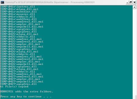

Kiki Burgh Posted May 8, 2006 Posted May 8, 2006 (edited) hi again sirs (Tomcat & tommyp)!as always, many thanks for your feedback!i just want to share what i've accomplished over the weekend (i was still using 503c though to make isos) ...here's what i've found out:(1) here are the added folders to the i386 dir + their contents:041bD:\SOURCESS\I386\041b\wmpshell.dll.mu_D:\SOURCESS\I386\041b\xpsp2res.dl_D:\SOURCESS\I386\041b\mlang.dll.mu_D:\SOURCESS\I386\041b\wmm2res2.dll.mu_D:\SOURCESS\I386\041b\wmploc.dll.mu_041eD:\SOURCESS\I386\041e\wmpshell.dll.mu_D:\SOURCESS\I386\041e\xpsp1res.dl_D:\SOURCESS\I386\041e\xpsp2res.dl_D:\SOURCESS\I386\041e\browselc.dl_D:\SOURCESS\I386\041e\inetres.dl_D:\SOURCESS\I386\041e\mlang.dll.mu_D:\SOURCESS\I386\041e\mshtmler.dl_D:\SOURCESS\I386\041e\msoeres.dl_D:\SOURCESS\I386\041e\shdoclc.dl_D:\SOURCESS\I386\041e\wab32res.dl_D:\SOURCESS\I386\041e\wmm2res2.dll.mu_D:\SOURCESS\I386\041e\wmploc.dll.mu_0402D:\SOURCESS\I386\0402\wmploc.dll.mu_D:\SOURCESS\I386\0402\wmpshell.dll.mu_D:\SOURCESS\I386\0402\xpsp2res.dl_D:\SOURCESS\I386\0402\mlang.dll.mu_D:\SOURCESS\I386\0402\msi.dll.mu_D:\SOURCESS\I386\0402\shdoclc.dl_D:\SOURCESS\I386\0402\wmm2res2.dll.mu_D:\SOURCESS\I386\0402\wmm2res.dll.mu_0418D:\SOURCESS\I386\0418\xpsp2res.dl_D:\SOURCESS\I386\0418\mlang.dll.mu_D:\SOURCESS\I386\0418\shdoclc.dl_D:\SOURCESS\I386\0418\wmm2res2.dll.mu_D:\SOURCESS\I386\0418\wmm2res.dll.mu_D:\SOURCESS\I386\0418\wmploc.dll.mu_D:\SOURCESS\I386\0418\wmpshell.dll.mu_0425D:\SOURCESS\I386\0425\wmpshell.dll.mu_D:\SOURCESS\I386\0425\xpsp2res.dl_D:\SOURCESS\I386\0425\mlang.dll.mu_D:\SOURCESS\I386\0425\shdoclc.dl_D:\SOURCESS\I386\0425\wmm2res2.dll.mu_D:\SOURCESS\I386\0425\wmm2res.dll.mu_D:\SOURCESS\I386\0425\wmploc.dll.mu_0426D:\SOURCESS\I386\0426\wmpshell.dll.mu_D:\SOURCESS\I386\0426\xpsp2res.dl_D:\SOURCESS\I386\0426\mlang.dll.mu_D:\SOURCESS\I386\0426\shdoclc.dl_D:\SOURCESS\I386\0426\wmm2res2.dll.mu_D:\SOURCESS\I386\0426\wmm2res.dll.mu_D:\SOURCESS\I386\0426\wmploc.dll.mu_0427D:\SOURCESS\I386\0427\xpsp2res.dl_D:\SOURCESS\I386\0427\mlang.dll.mu_D:\SOURCESS\I386\0427\shdoclc.dl_D:\SOURCESS\I386\0427\wmm2res2.dll.mu_D:\SOURCESS\I386\0427\wmm2res.dll.mu_D:\SOURCESS\I386\0427\wmploc.dll.mu_D:\SOURCESS\I386\0427\wmpshell.dll.mu_(2) on the early stages of slipstreaming, HFSLIP reported that a particular KB added some folders; i tried taking it out though but the same additional folders (above) still showed up in SOURCESS(3) i think i already resolved my XPize issue ... it was totally my bad ... ... i was using an XPized SP2 SOURCESS (as XPize has a feature to create a bootable XPized ISO) ... when i just used SOURCESS from HFSLIP, T-13 didn't show anymore the installation prompts of XPize ... oh well, a lesson learned! (4) would RyanVM's Windows XP Post-SP2 Update Pack work hand in hand with HFSLIP? you see, in 1 of my experimental builds, i checked the contents of the package & removed from the HF directories those files that are in the cab file ... now when i ran qfecheck, it only shows those that were in the addon pack ... & not those in the HF folders ... i've attached a text file for your reference(5) these 2 don't seem to do anything for the system: Themes_rytukz_VistaCG_addon_v1.0.cab Themes_rytukz_VistaCG_addon_v1.1.cab ... i tried each 1 at a time & i tried even having both ... to no avail (no theme added for me to use) ... checking both files though do not seem to show any pic file ... btw, 1.0 has a bigger size compared to 1.1 due to the difference in compression(6) would it be possible to replace snap ons like dfrg.msc via HFEXPERT\APPREPLACEMENT?(7) would the reference (or update at least) for slisptreaming CODECS be applicable to XP too? apparently, the discussion in a different thread is for 2K(8) is there a difference between letting HFSLIP integrate SP than doing it manually?(9) just a follow up, i know it might be too much to ask but could the entire process (from start to finish) be generated as a separate report too (so that we can see all the messages/errors/processes that have transpired during the run of HFSLIP)(10) lastly, about timing the slipstreaming process, would it be alright to request for the start & end times be included in the log as well?cheers!hotfixes.txtHFSLIP.txt Edited May 9, 2006 by Kiki Burgh
Super-Magician Posted May 8, 2006 Posted May 8, 2006 (edited) (2) Kiki, can you tell us the KB number that HFSLIP reports?(8) Nope! (9) I'd like something such as this, but because certain screens are echoed and cleared (CLS), it would not work. Normally, you would do something like HFSLIP_60507b>MESSAGES.LOG at the command prompt, but then the initial screens/messages, etc. won't show up on the screen. However, if you'd like to show any error messages in a file, type HFSLIP_xxxxx 2>ERROR.TXT.(10) I second this idea ! Edited May 8, 2006 by Super-Magician

Kiki Burgh Posted May 9, 2006 Posted May 9, 2006 hi sirs (Tomcat, tommyp, Super-Magician)!thanks again for the immediate response ...my apologies but i actually had the file sitting somewhere here ... I couldn't find it though when i posted earlier ... no i found it ...it is KB883921 (http://support.microsoft.com/kb/883921/en-us)cheers!
Tomcat76 Posted May 9, 2006 Author Posted May 9, 2006 Kiki...HFSLIP doesn't support MUI updates. I don't think anyone here knows where all those *.mui files should go and there are 8 of each in that hotfix. Do you have an MUI version of XP?General: Is it actually possible to make a regular WinXP source an MUI-enabled one out of the box?
Kiki Burgh Posted May 9, 2006 Posted May 9, 2006 thanks for the update sir!i will just take this KB out of the HF directory for good. good morning!
