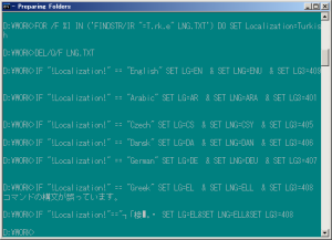

Nanasi3 Posted November 9, 2007 Share Posted November 9, 2007 1.6.6rc4 doesn't run correctly on Japanese XP SP2.The script is terminated at the GET LUNG section.The 3199th line of the script is garbled in Japanese command prompt, and seems to cause the error. Link to comment Share on other sites More sharing options...
Tomcat76 Posted November 9, 2007 Author Share Posted November 9, 2007 @Nanasi3Thanks for reporting this. Can you verify that it's fixed in 1.6.6 RC5? @GlowyDo you have the same problem with RC5? Try rebooting your system and do a chkdsk too. Link to comment Share on other sites More sharing options...
