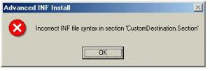

then while installing files from QFE.INF file I get this error message:
And the ME pack keeps on prompting me for the GDI.EXE, GDI32.DLL, UPDATE.SYS and KRNL386.EXE files.
I checked the unoffupd.inf file and I think it needs some modifications. Change the [sourceDisksNames] section that says:
"1=,,0" to 1=,"supp.cab",0 so that the ME pack can install those files from the supp.cab file.
I also checked the QFE.INF file that mentions the CustomDestination=CustomDestination.Section string.
I found out that there is no [CustomDestination.Section] section in the qfe.inf file. Please add the missing [CustomDestination.Section] string to elliminate that error message in the picture above (Note: if you're having trouble seeing that picture, click on it to view it in another browser window and it will be displayed a little bigger).
Hopefully the Rundll32 problem gets fixed in the next beta.

Thanks for the report.
New version! This is still Beta 2, but it is version 2 of the beta.
Hosted on mytempdir, id 498247.
Fixed all bugs reported.
