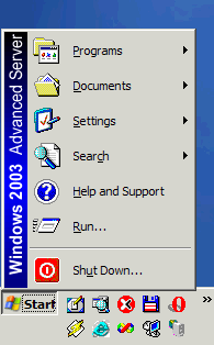

My system perfectly works on 16bpp mode, with full color icons. after installing xpize something was destroyed. All I need to known to recover my win -- that kind of changes was applyed through xpize settings after selection icons size and, probably, after changing "desktop view style". Are you able to help me? or better I must ask kavalera?
I attached some screen parts of current state of my system after installing Xpize.
please, do not advise video card upgrade, I just need to restore previous system icons look, what was perfectly...
thanks.
In the fisrt screenshot I see the XPize shortcut arrows. I think you havent uninstalled XPize properly. And yes, you can PM kalavera if ou want to know the exact changes XPize Settings make.
sorry, I confused you with my screens... I made few install/uninstall cycles, and between some of them I made screens.
ok, thanks for the help, I'll try to ask kavalera.

no, it seems to be bug at xpize settings... more information -- the problem seems related to explorer only (desktop/my computer windows and common dialogs), because some of programs displays true color icons correctly... and after changing of my computer/recycle bin icons to true color through standard "customize desktop" from the dll's there icons really true color -- at "customize desktop" dialog it displayed correctly, but at desktop -- not :-(
anyway, this constricts possible variants...
