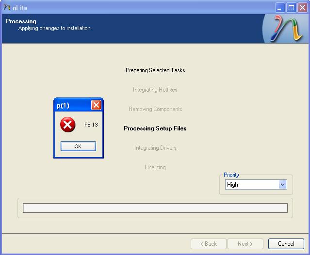

ruben-m Posted December 5, 2005 Posted December 5, 2005 (edited) While making a cd using nlite 1.0 RC3, I get and pop-up which tells me the following: PE 13. It looks like an error, and after pressing the OK button, setup simply continues. Is this a known problem? What does it mean?I attached a picture of the problem. Edited December 5, 2005 by ruben-m
Fernando 1 Posted December 6, 2005 Author Posted December 6, 2005 While making a cd using nlite 1.0 RC3, I get and pop-up which tells me the following: PE 13. It looks like an error, and after pressing the OK button, setup simply continues. Is this a known problem? What does it mean?I am not an expert in the deep processing structure of nLite (you have to ask Nuhi himself), but AFAIK this popup means, that there has been an error within step 13 of the nLite processing.Did you open and edit any SIF file (WINNT.SIF or TXTSETUP.SIF)?You have written, that nLite continued the processing unless the error message. What was the result?
