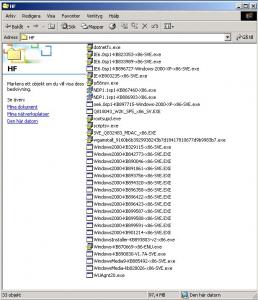

Hello
This is my first post on the hfslip thred i hope i post it right
I have some problem using hfslip i am trying to slipstream new hotfixes to a swedish windows2000 disk. Hfslip slipstreams all the hotfixes and wmp9,dx9 and ie6 with no errors. I have followed hfslips guide.
The cd boots fine but the problem is after install has copied all the files and repartion the drive and then restart the install tries to go in to the part detecting devices but it fails and restarts over and over again and dosent continue.
What can be the problem hotfixes taking out each other?
I attach a picture showing what i am trying to slipstream
Edited by rabidrodent

  • Author
@PeterGau - The issue you have with HFSLIP is because you renamed the files you downloaded from Microsoft. A typical type 1 HF has this name:
WindowsXP-KB885836-x86-ENU.exe (for English anyway). I sent you a PM to help you rename your files.
@rabidrodent - Obviously you didn't read the instructions on the first posting of this thread.
* The following do NOT belong in your HF folder.
dotnetfx.exe, js56nsv.exe, the two NDP files, Q818043, Q832843. In fact, you don't need any of those files.
*The following files are named incorrectly and not processed correctly:
WGA and the WUAgent20. Please refer to http://www.vorck.com/2ksp5.html on how to get the correct files and what to do with them.
* http://www.vorck.com/2ksp5.html also tells you how to work with the dotnet installation.
