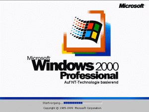

murvun Posted August 24, 2005 Posted August 24, 2005 (edited) once again: no other infinite boot-loops here?is it a problem of vm, of german w2k or is my source corrupted?seems that <F8> and 'safe mode' (abgesicherter modus) helps, but why?thanks...edit: sorry for panic: same boot-problems also with naked w2k - sp4 without hfslip,so it is not a hfslip-problem! Edited August 29, 2005 by murvun

fdv Posted August 25, 2005 Posted August 25, 2005 murvun, i agree with tommyp's assessment. it sounds like you are not starting with a win2k that has sp4.
