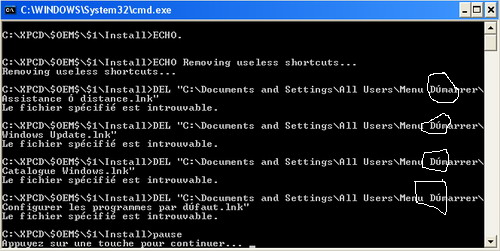

hi i tried everything but i couldn t delete the shortcuts
I think i know where the problem comes from but i don t know how to fix it
this is wha I write in my batch file
ECHO.
ECHO Removing useless shortcuts...
DEL "%systemdrive%\Documents and Settings\All Users\Menu Démarrer\Assistance à distance.lnk"
DEL "%systemdrive%\Documents and Settings\All Users\Menu Démarrer\Windows Update.lnk"
DEL "%systemdrive%\Documents and Settings\All Users\Menu Démarrer\Catalogue Windows.lnk"
DEL "%systemdrive%\Documents and Settings\All Users\Menu Démarrer\Configurer les programmes par défaut.lnk"
the problem is that I use a french Windows XP "Start Menu" in french is "Menu Démarrer" but when i execute the batch file i got "Menu dÚmarrer"
so how can i Fix it Please
Thanx in Advance

I tried all the Method But the problem Is it couldn t Access "menu démarrer" Folder i think windows on command prompt can t read "é" it keeps saying c:......\\\\\menu dumarrer\... path is incorrect
it changes the "é" into u ??
so is there anything else i can do ??
