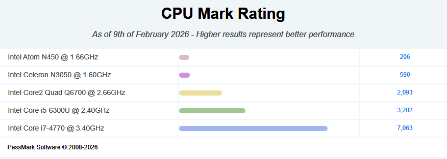

Hello NotHereToPlayGames,
MSFN certainly is no forum for Linux experts.
Nevertheless here are some charts for you.
Contrast these charts with M$ Windows11 !!
(By Gary Sims & Andy Walker)

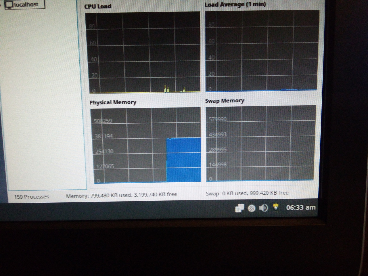

I may revisit Q4OS.  I actually suspected from the get-go that I made a *MISTAKE* when *not* selecting the TRINITY desktop.
I did not screencap, but Q4OS ate up 6.5 GB of only 8 GB RAM.
That was on a DIFFERENT computer, but still, that's one helluva lot of RAM consumption just for the desktop!

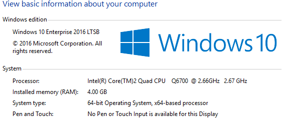

I opted to install 10 first.
Admittedly, I fear that to be a mistake because I will very likely end up with 10 so I should have done it last.

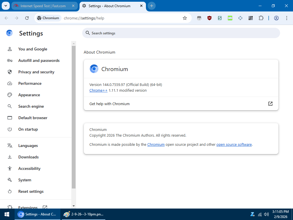

In 10, my test-case browser is not going to be the same as my test-case browser when I install 7.
Mainly because 10 has MORE AVAILABLE and 7 will be "limited" to something like e3kskoy7wqk or r3dfox.
While some may consider this to not be "apples to apples", that is not my goal here, I want to know if 7 or 10 is "better" for YouTube.
And that will determine which OS *stays* on this 'junk hardware'.
Should still be "very close" (e3k-needs-easier-name has a HIGHER version of Chromium as I write this).

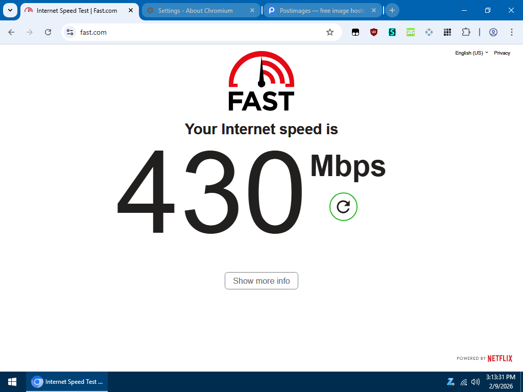

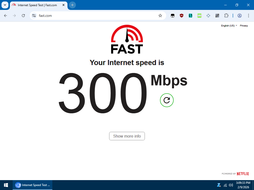

My wi-fi is pretty fast.  Yeah, I'm only on a 500 Mbps ISP but my wi-fi connects anywhere from 300 all the way to the full 500.
Two TV's are currently streaming news so that does bring me down a tad during these screencaps.
At any rate, this is PLENTY FAST ENOUGH for YouTube "watchability".

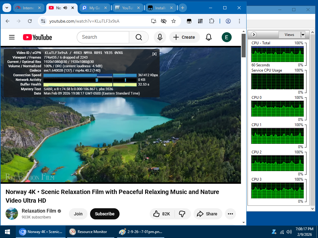

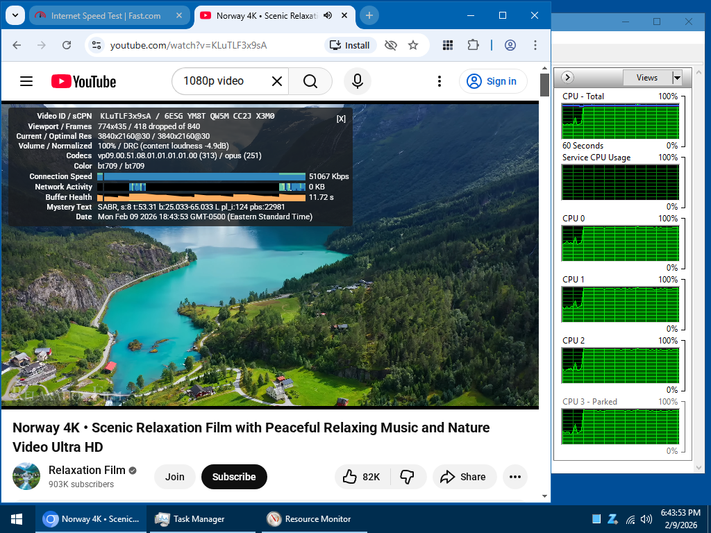

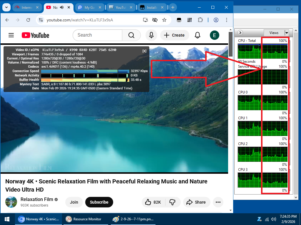

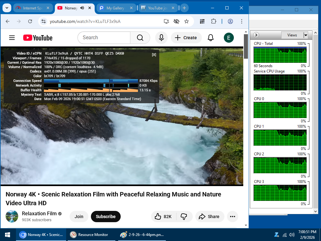

1080p but avc1 instead of av1.
Some "breathing room" for cpu multitasking, but not much.
"h264-ify" userscript:
