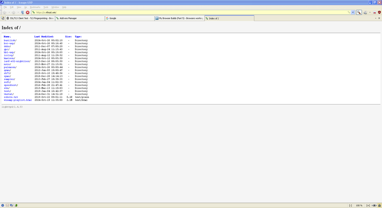

AstroSkipper Posted October 30, 2024 Posted October 30, 2024 (edited) On 10/29/2024 at 10:29 AM, w2k4eva said: Here are screenshots for the linked sites. Lest you assume it is some sort of network blockage or firewall issue - no, it is able to visit the Qualys site, it seems to report TLS1.3 being available as expected. While these screenshots are being made with iceape default profile that has no addons, I get the same results in my seamonkey install with its usual addons, which in time past used to be able to visit github until fairly recently. I even tried installing JustOff's polyfill addon (since I use it on my W7 system running 2.53.19) but that makes no difference on the XP system, not sure if it can really work in Seamonkey 2.49 even after installing, but it does not help either seamonkey 2.49 nor iceape. What I find odd is that iceape supposedly has TLS1.3 available where seamonkey 2.49 does not, yet that seems to make no difference in what sites the browsers can connect to. There is no problem with IceApe. I can easily connect to all websites. Here is a screenshot regarding the https://o.rthost.win/ site: Either your browser is misconfigured or something is blocking some of your connections. Check your network settings, internet connection settings, security settings, and update your root certificates! In any case, the problem is on your side. And don't forget that the problem can also be sitting in front of the computer! (Old computer wisdom.) Edited October 30, 2024 by AstroSkipper 4
