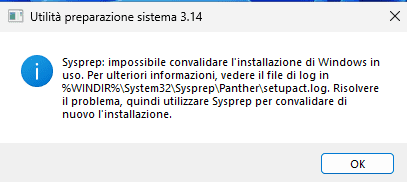

DMD61 Posted October 2, 2023 Posted October 2, 2023 (edited) Good morning. I detect this error message due to the installation of an App (SpeedtestbyOokla) from the store that returned the following message: 023-10-02 12:20:55, Error SYSPRP Package Ookla.SpeedtestbyOokla_1.16.165.0_x64__43tkc6nmykmb6 was installed for a user, but not provisioned for all users. This package will not function properly in the sysprep image. 2023-10-02 12:20:55, Error SYSPRP Failed to remove apps for the current user: 0x80073cf2. 2023-10-02 12:20:55, Error SYSPRP Exit code of RemoveAllApps thread was 0x3cf2. 2023-10-02 12:20:55, Error SYSPRP ActionPlatform::LaunchModule: Failure occurred while executing 'SysprepGeneralizeValidate' from C:\Windows\System32\AppxSysprep.dll; dwRet = 0x3cf2 2023-10-02 12:20:55, Error SYSPRP SysprepSession::Validate: Error in validating actions from C:\Windows\System32\Sysprep\ActionFiles\Generalize.xml; dwRet = 0x3cf2 2023-10-02 12:20:55, Error SYSPRP RunPlatformActions:Failed while validating Sysprep session actions; dwRet = 0x3cf2 2023-10-02 12:20:55, Error [0x0f0070] SYSPRP RunDlls:An error occurred while running registry sysprep DLLs, halting sysprep execution. dwRet = 0x3cf2 2023-10-02 12:20:55, Error [0x0f00d8] SYSPRP WinMain:Hit failure while pre-validate sysprep generalize internal providers; hr = 0x80073cf2 Only by uninstalling this App is generalization possible. I ask if there is a procedure to install third-party Apps avoiding the sysprep error. I also tried disconnecting the network, after installing the APP, but I get the same error message. Thank you Edited October 2, 2023 by DMD61

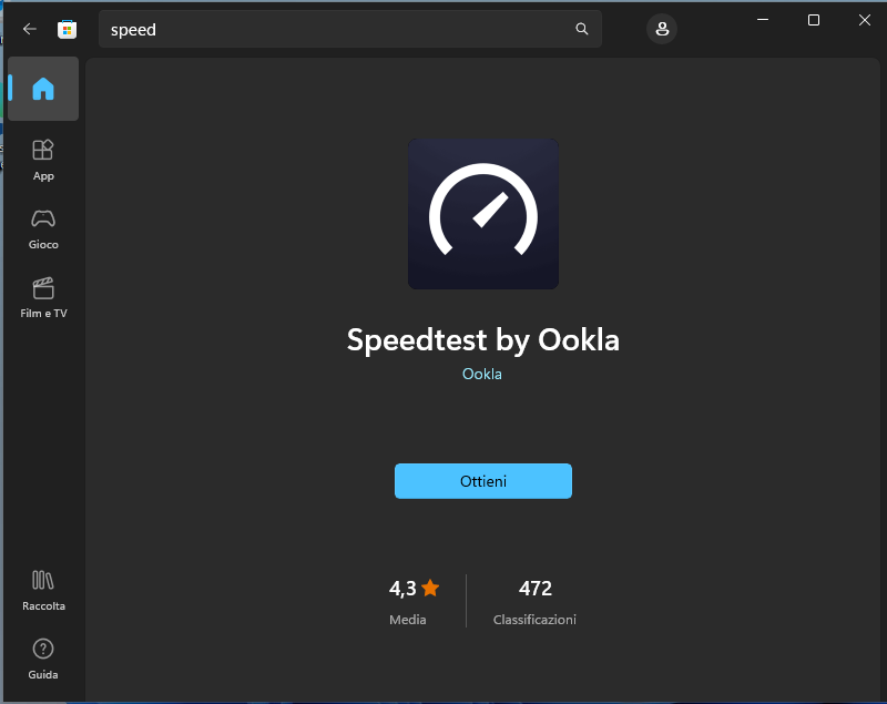

DMD61 Posted October 2, 2023 Author Posted October 2, 2023 (edited) I thank you very much for the valuable information. I ask a stupid question, where do I get the url link of the app in the Microsoft Store? Edited October 2, 2023 by DMD61
UCyborg Posted October 2, 2023 Posted October 2, 2023 I don't recall encountering an option to get it from the Microsoft Store app itself, but you can browse your way to the app on Microsoft Store's website at https://apps.microsoft.com/store/apps, when you open the desired app's page, you'll have the right link in the web browser's URL bar.
Guest Posted October 2, 2023 Posted October 2, 2023 (edited) 2 hours ago, UCyborg said: I don't recall encountering an option to get it from the Microsoft Store app itself, but you can browse your way to the app on Microsoft Store's website at https://apps.microsoft.com/store/apps, when you open the desired app's page, you'll have the right link in the web browser's URL bar. Actually, there's an option to get the URL from Microsoft Store, click the Share button (which is at the bottom, the red circle), then under Share using section, click All apps >, then click Copy link: Edited October 2, 2023 by mina7601

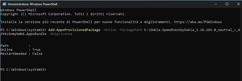

DMD61 Posted October 2, 2023 Author Posted October 2, 2023 (edited) @mina7601 Thank you for this alternative method. @UCyborgI followed the procedure, and entered the Powershell command as administrator, in the virtual machine I still don't see the App. Nevertheless I performed stop and generalize, and after that I created new ISO and verified that the App is not present. Did I do something wrong in the procedure? Thank you Edited October 2, 2023 by DMD61
UCyborg Posted October 3, 2023 Posted October 3, 2023 No idea, I've never actually done sysprepping, I just suggested possible fix for this specific error: On 10/2/2023 at 1:54 PM, DMD61 said: 023-10-02 12:20:55, Error SYSPRP Package Ookla.SpeedtestbyOokla_1.16.165.0_x64__43tkc6nmykmb6 was installed for a user, but not provisioned for all users. This package will not function properly in the sysprep image. But searching around, I only find web sites saying to remove the problematic package(s). Error suggests it should be provisioned for users, which I assume is the job of Add-AppxProvisionedPackage: Quote Adds an app package (.appx) that will install for each new user to a Windows image.
